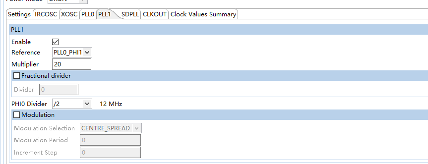

Hello,I have a new problem about the setting of PLL1,please see the pictures:pastedImage_1.png

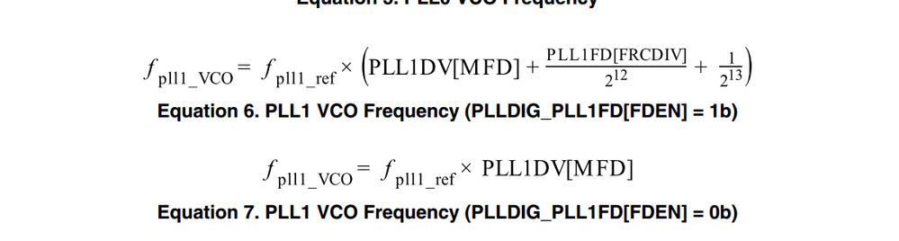

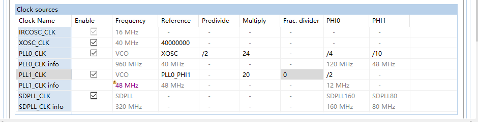

this is a setting I tried,but I am failed,in this setting,I set the " PLLDIG_PLL1FD[FDEN] = 0b "pastedImage_2.png In the reference manual,the PLL1 VCO should be 48MHz * 20 = 960MHzpastedImage_3.png
isn't it?

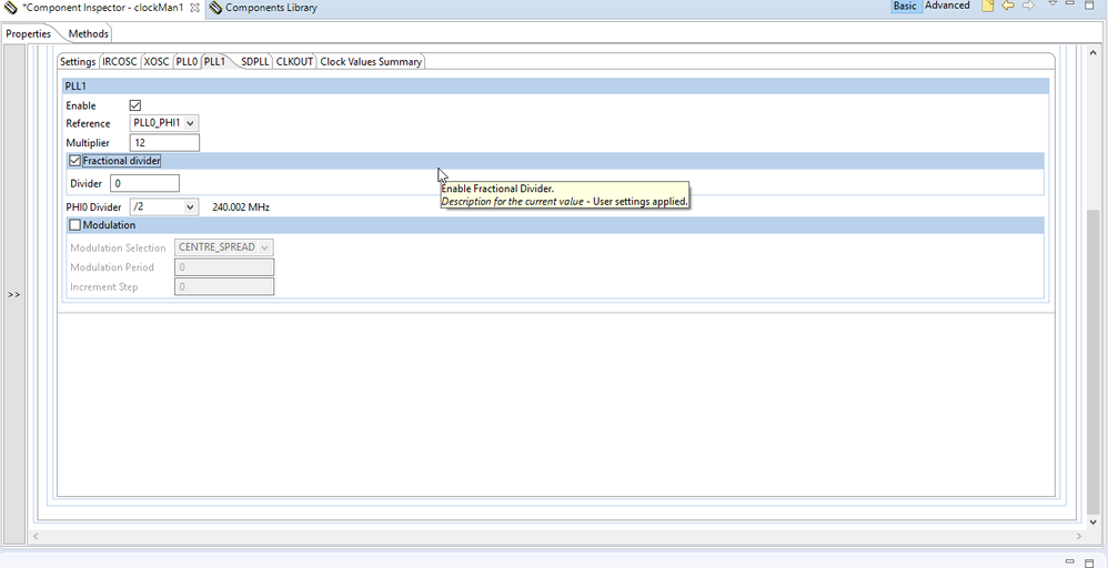

it looks like that you don't have enabled Fractional divider in PLL1 settings:
The VCO means Voltage-controlled oscillator. More info about Fractional Divider you can find in Reference Manual chapter 34.4.3.1 (page 1226 - S32R274 Reference Manual, Rev. 4, 05/2018 ).

For example,I set the parameters same as the question.I think the VCO should be 960MHz,but the result is 48MHz,I don't know why?The equation is that:pastedImage_1.png
To my understanding,the Fpll1_ref is 48MHz,MFD is 20,the pll1_VCO should be 960MHz.

I went through RM - and you are right. When the FD is disabled - the output should be in your case 960MHz. So - I'll report this as a Processor Expert bug. Thank you for report. In my opinion - the real HW will work as expected. But I didn't test it yet.
