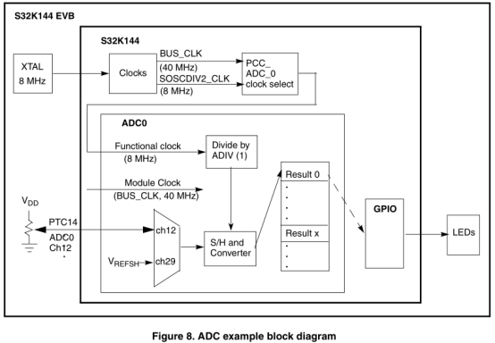

Hi NXP Engineer:

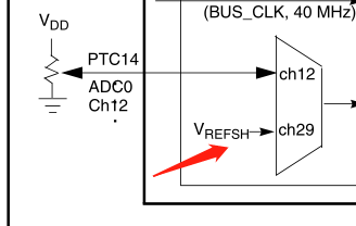

      I have a problem with Project from Example —— ADC_s32k144. In the code i see the function which (Convert chan 29, Vrefsh) at the end.
I want to know what is it used for?I can serach the note AN5413,and find some description and image like this
but also understand what this function is for doing.
I don't know why need to connects ch29.colud you tell me?
Thanks in advance.
Tags (3)
1,936 Views
jiri_kral
if I understand this example correctly - in adcResultInMv_Vrefsh you get voltage reference high - which is connected to Channel 29. You don't need read this value - it is kind of feature for this example (you can setup breakpoint and check measured Voltage reference) - but not used for LEDs control.
Hope it helps.
Jiri
1,936 Views
kemingkai
OK,I understand it.Thank you for your help, because there is no comment, I don’t dare to judge this function by experience.
