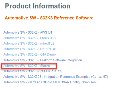

Hi @david2023
S32K3 Reference Software already contains TCPIP stack with LWIP demo which is supposed to be used in S32DS 3.5:
https://www.nxp.com/webapp/swlicensing/sso/downloadSoftware.sp?catid=SW32K3-REFSW-D
Lukas
