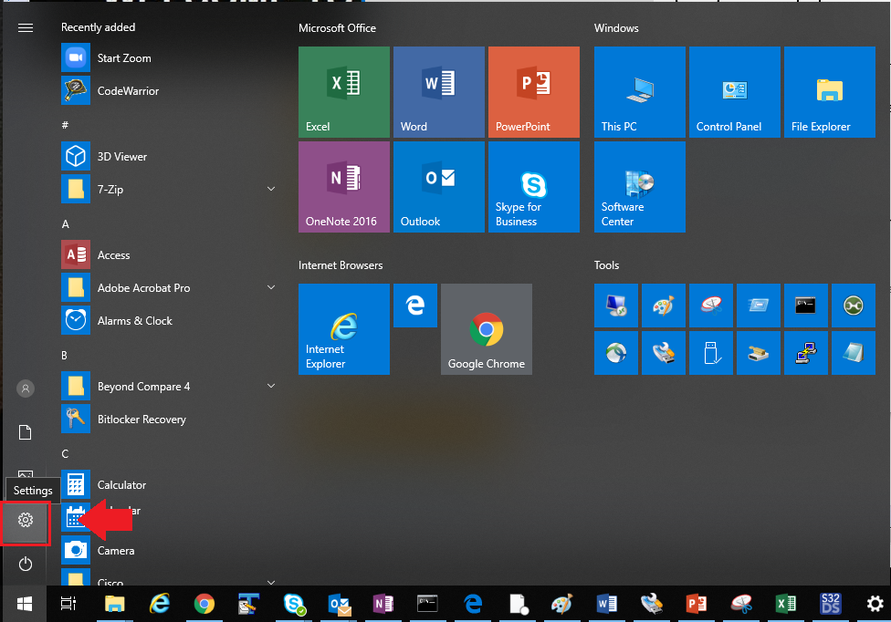

1) Click on 'Settings' from the Windows Start Menu

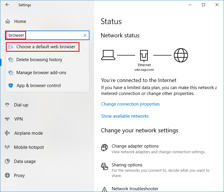

2) Type 'browser' in the search bar, then select 'Choose a default web browser'

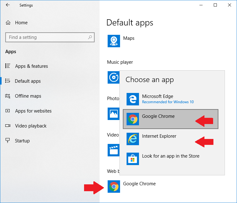

3) Click on the currently selected Web browser to bring up the selection menu and select 'Internet Explorer' or 'Google Chrome'
4) Relaunch S32 Design Studio and try again to open the document from the link in Getting Started page.
