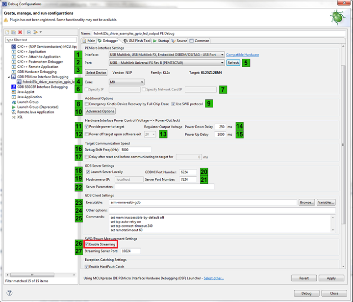

Note: To set up streaming for SWO debug features, the user should check the “Enable Streaming” checkbox in Debug Configurations during setup. Then the port should be specified in the Streaming Server Port text box.

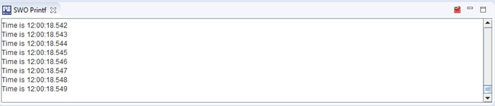

SWO Printf Console
The SWO Printf Console will display messages which are streamed through the SWO pin and captured by the Multilink. There are two main configuration steps needed to leverage this feature. First, the project must be configured to re-direct the printf() statements to the SWO Printf peripheral. This is done at project creation time.
Second, the green "Play" button on the SWO ITM Console needs to be clicked during an active debug session. This will cause data collection of SWO printf information to occur on the next Resume. Once data is streaming, the red “Stop” button will stop data streaming.
Printf() Statements Displayed In SWO ITM Console
The Multilink automatically measures the data communication rate on the SWO pin and adjusts to it automatically. This auto-detect sequence is done each time the processor is stopped in debug mode. If the running code changes the core frequency, a breakpoint should be set after the frequency change so the Multilink can adjust to the new SWO communications rate (which is a function of the core frequency).

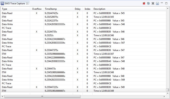

SWO Data capture
The SWO Data view allows the user to configure variables to be tracked such that any reads and writes to these variables are captured and streamed to the Multilink via the SWO pin. This view shows all of the realtime access which have occurred along with the timing of the different accesses.
For SWO data, there is a bit more setup.  The user needs to select the 'Eyeglasses+' symbol which will bring up a popup of Add datawatch items.  Simply enter the information of the different variables to be tracked. Up to four separate variables can be tracked simultaneously. In this example, we select that we wish to capture read and writes of the ledsOn and seconds variables. Once added, the user needs to select which watches data will be captured by checking the "Enable trace" boxes in the SWO Data window and then click the Green Arrow to set the program to start capture on Resume.Upon resuming the application, the right side of the window will show the access which are occurring. Note that this happens in real-time; the microcontroller is not stopped when accesses occur (i.e. the is separate from data breakpoints).
Variable Read/Writes Displayed In Real Time

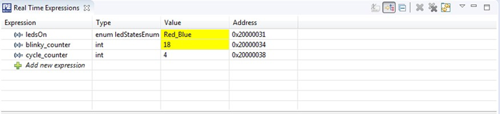

Real-Time Expressions
This view is similar to the standard Eclipse "Expressions" window with the exception that its contents will update in real-time without the device being halted in debug mode. Just add the appropriate variables to the Real Time Expressions window and you will see them updating in real-time.
Add Variables To Real-Time Expressions Windows
