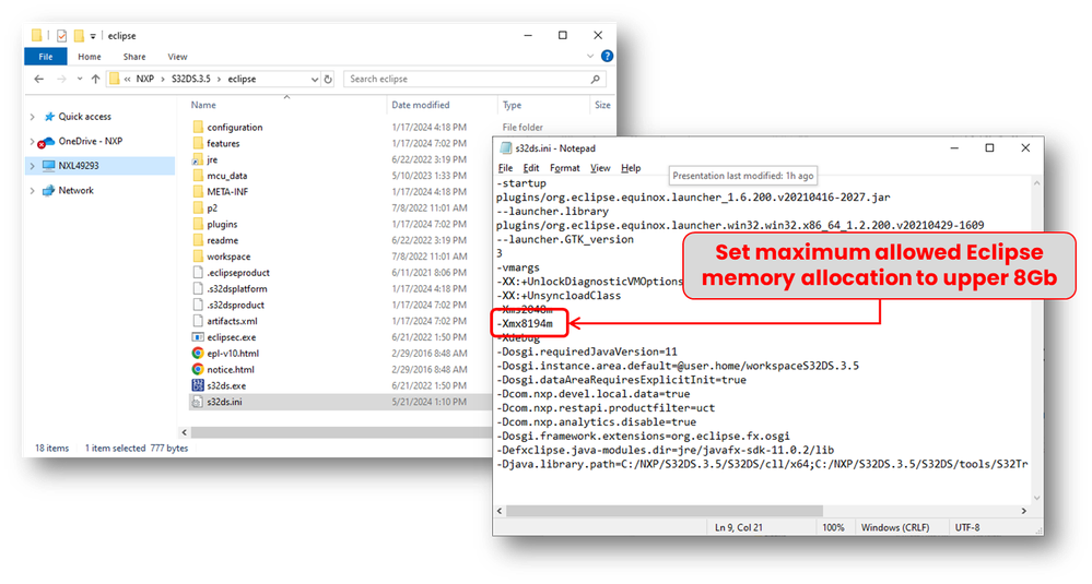

Use-Case #1: S32 Design Studio takes to much time to perform some of UI update operations
Workaround: Manually update the Eclipse configuration parameters in the s32ds.ini file

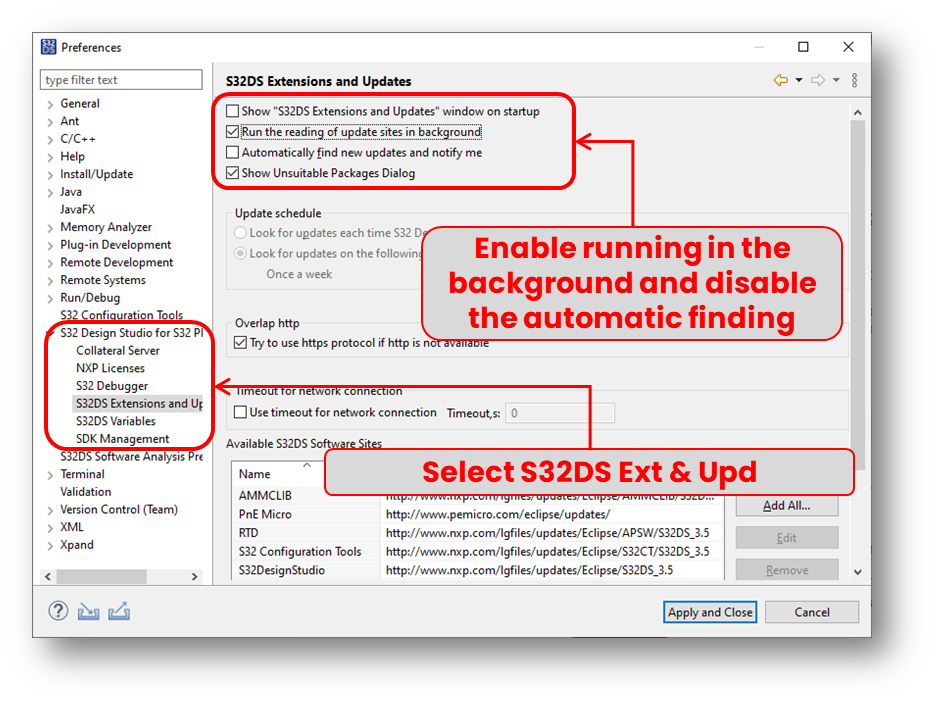

Use-Case #2: S32 Design Studio takes a lot of time to open waiting for updates checking to finish
Solution: Update your environment to use at least Update12 or newer or disable the checking at startup

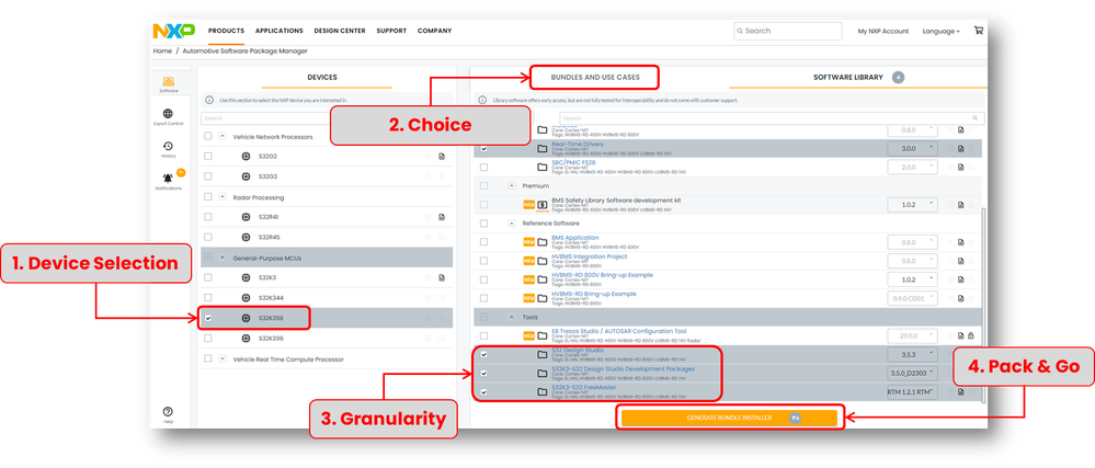

Use-Case #3: Control of package dependencies between RTD and S32DS during install/update flow
Solution: Transition to Package Manager as the main/single delivery solution for SW and Tools installation. The concept of “Bundles & Use Cases” guarantee interoperability and come with customer support.
