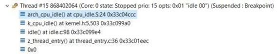

Debug window
The Zephyr threads are listed in the Debug window when the CPU is stopped.
This is an example about how to follow thread entry can be read:
The Thread with index #15 and thread ID 868402064 (TCB (Thread Control Block) address in decimal format) is running on the CPU core 0 and it is in the Stopped state.
It has running priority 15, the user options 0x01 and its name is “idle 00”.
This is suspended in a breakpoint set in function arch_cpu_idle();

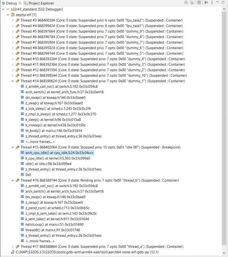

CPU registers
The CPU registers of the thread selected in the Debug window can be read from the Registers window. This window is updated automatically when other thread is selected.

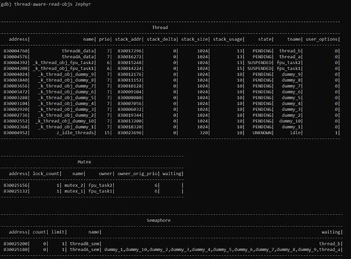

GDB (GNU Debugger)
This support is available through extended GDB commands.
Command name
Description
thread-aware-list-supported-os
List the supported OS types and the detected OS
thread-aware-list-supported-objs
List the supported kernel objects by the detected or specified OS. This is based on types used by the current image only.
thread-aware-read-objs
Read the specified or all objects supported by current image.
These commands can be configured to supply the output in JSON (JavaScript Object Notation) or table format.
Use the help command to get more information about these thread awareness commands.

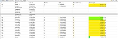

Thread view
This window can be accessed from the menu RTOS/Zephyr RTOS/Threads.
Figure 4 DS IDE - Thread view
Some information can be missing from the view depending on the build configuration used. For example, in the above figure, the Peak stack usage is not available because the CONFIG_INIT_STACKS is not set.
Note the Thread’s field names into DS IDE Thread view can be different than GDB Thread attributes.
Stack
The thread view holds more information about the stack.
The Stack usage stands for the current stack usage, and it is based on SP (Stack Pointer) register while the Peak stack usage stands for the maximum usage of the stack.
