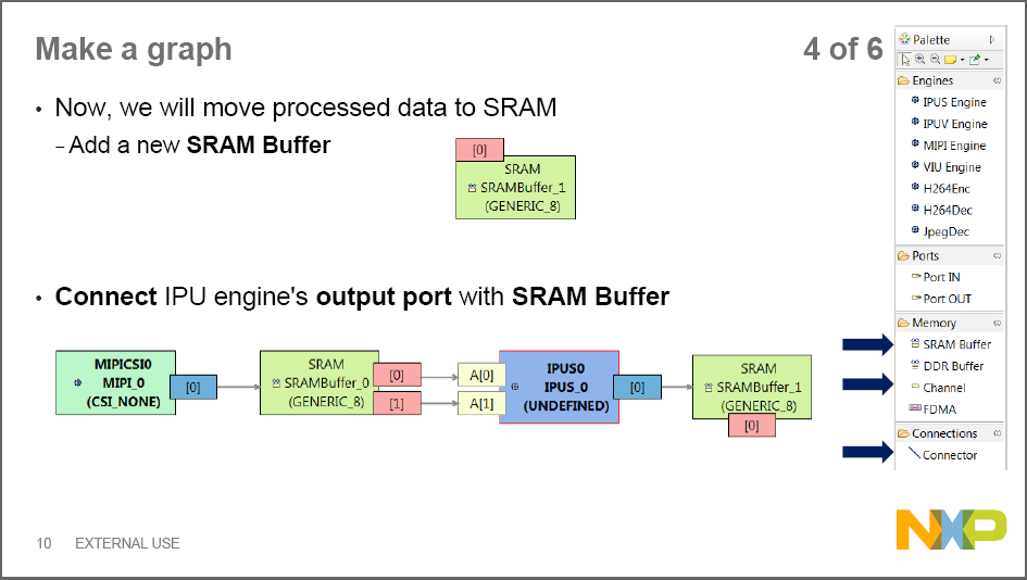

This tutorial walks a user through the steps to create a new application for the S32V234 MCU using S32DS for Vision and the built in ISP Visual Graph tool. The completed application will take an image from camera, processes it on ISP and put the processed image in DDR buffers. Once the image is in DDR buffer, host (A53 core running Linux) will direct the display control unit (DCU) to display it on screen.
