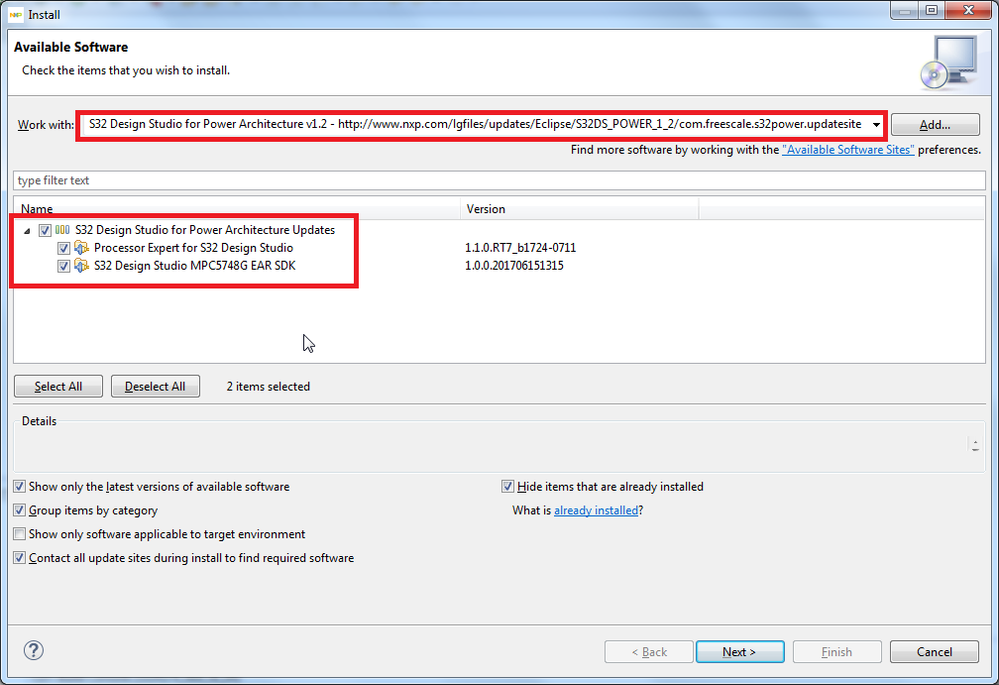

The update is available for online (Eclipse Updater) or offline (direct download link) installation.
select all available items and click "Next" button

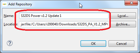

  • offline installation: go to S32 Design Studio product page -> Downloads section or use the direct download link to download the "S32 Design Studio for Power v1.2 - Update 1" file.
Start S32DS and go to "Help" -> "Install New Software..."
Add a new "Archive" repository and browse to select the downloaded Update 1 archive file:
Select all available items and click "Next" button.
