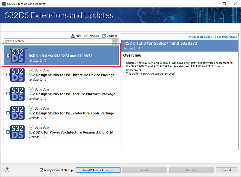

    • go to menu "Help" -> "S32DS Extensions and Updates" dialog
    • select from available items and click "Install/Update" button

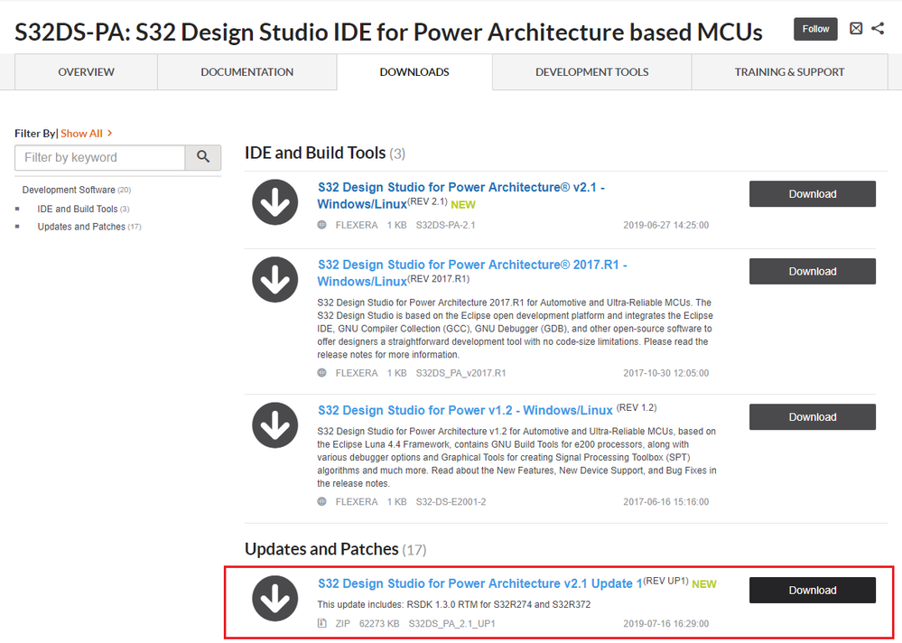

    • go to S32 Design Studio for Power product page -> Downloads section or use direct link to download the update archive zip file pastedImage_2.png

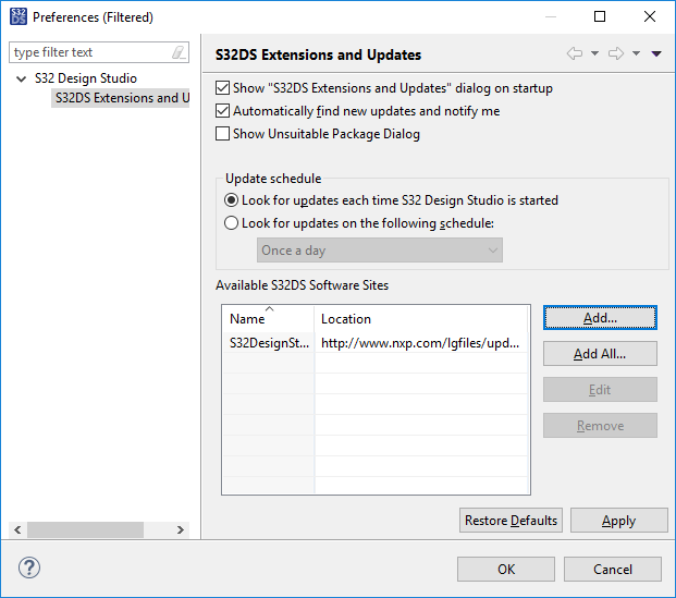

      • Start S32 Design Studio and go to "Help" -> "S32DS Extensions and Updates", then click 'Go to Preferences' link
      • And add a new site "Add..." repository and browse to select the downloaded update archive zip file you downloaded in the previous step
      • Select the 'RSDK 1.3.0 for S32R274 and S32R372' package and click "Install/Update" button.
This will start the update installation process.
