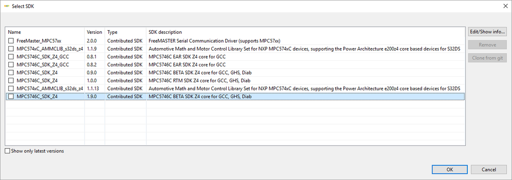

  • MPC574xx SDK BETA 1.9.0

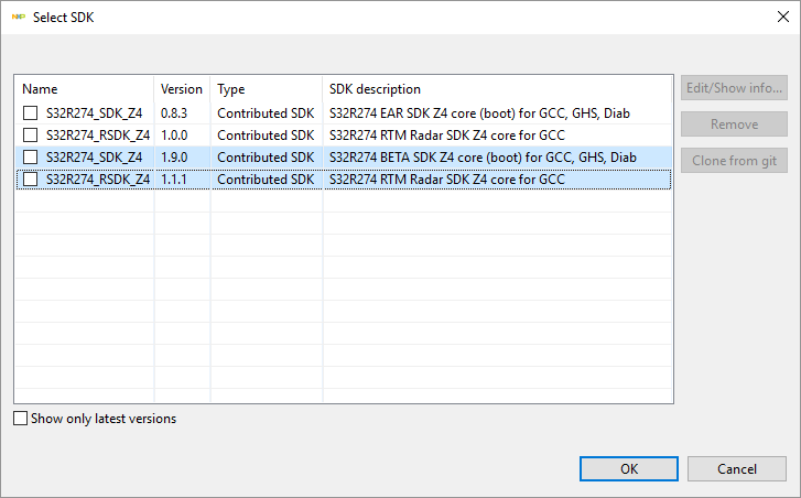

  • S32R SDK BETA 1.9.0
  • Radar SDK for S32R274 & S32R372 RTM 1.1.1

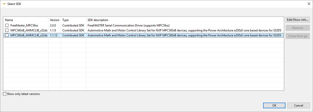

  • AMMCLib 1.1.13 for MPC560xB, MPC560xP, MPC564xL, MPC567xF, MPC567xK, MPC574xC, MPC574xG, MPC574xP, MPC574xR, MPC577xC, MPC577xK,  MPC577xM

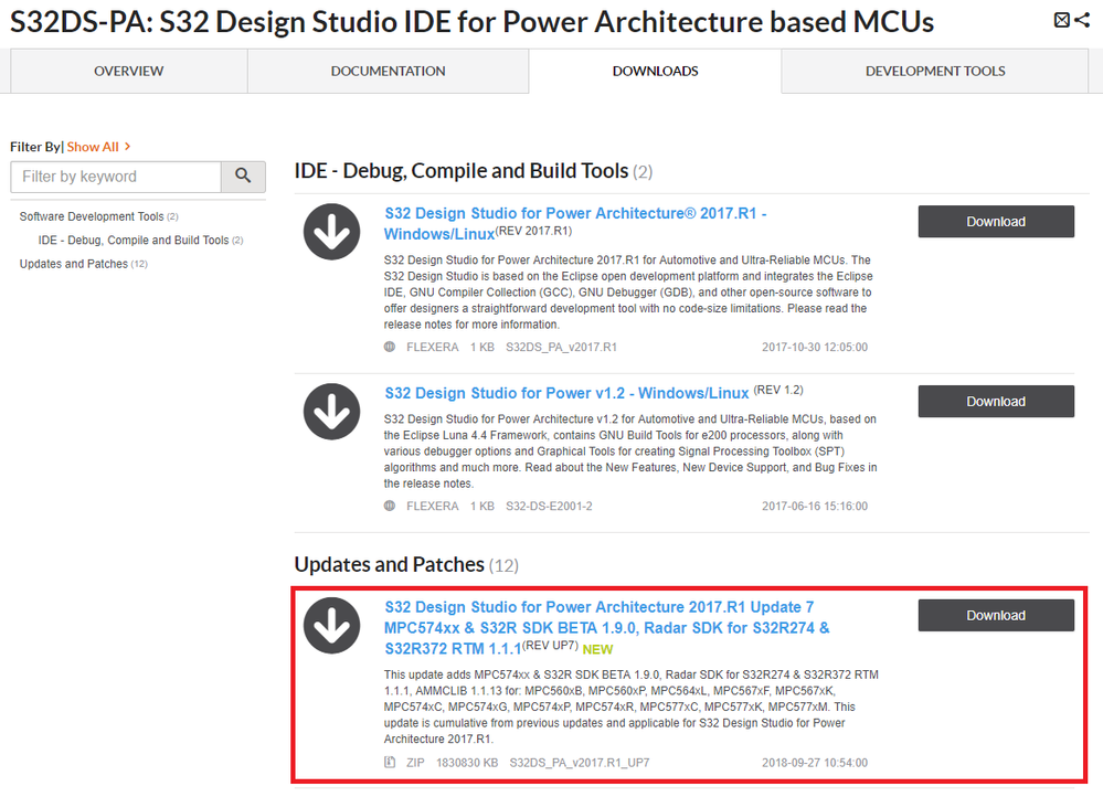

The update is available for  (via S32DS Eclipse Updater) or offline installation (direct download link)
  • offline installation:
    • go to S32 Design Studio for Power product page -> Downloads section or use direct link to download the update archive zip file pastedImage_20.png

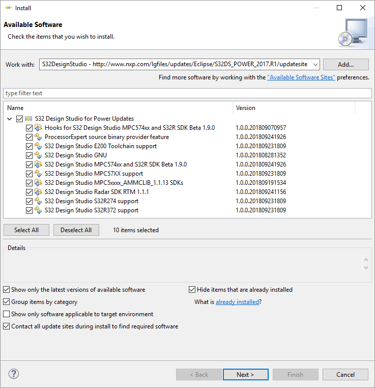

      • Start S32DS and go to "Help" -> "Install New Software..."

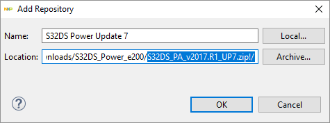

      • Add a new "Archive" repository and browse to select the downloaded update archive zip file you downloaded in the previous step
      • Select all available items and click "Next" button.
This will start the update installation process.
