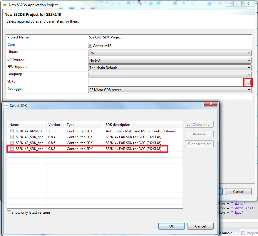

  • S32 SDK 0.8.6 EAR (Early Access Release)  for S32K142, S32K144, S32K146, S32K148)- see attached release notes for more details

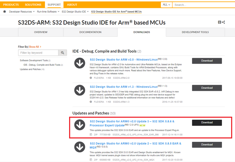

The update is available for online (via Eclipse Updater) or offline installation (direct download link)
  • offline installation:
    • go to S32 Design Studio for ARM product page -> Downloads section or use this direct link to download the update archive zip filepastedImage_20.png

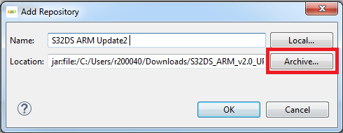

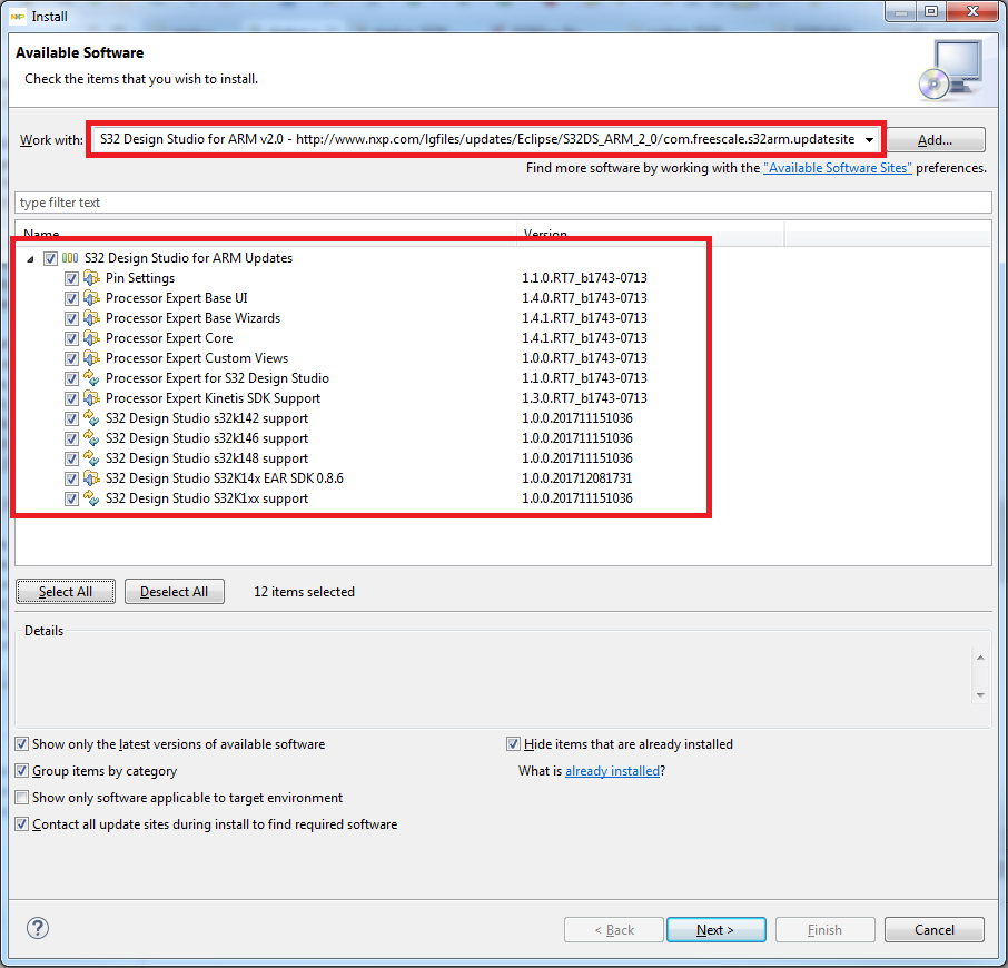

    • Start S32DS and go to "Help" -> "Install New Software..."
    • Add a new "Archive" repository and browse to select the downloaded update archive zip file you downloaded in the previous step
    • Select all available items and click "Next" button.
This will starts the update installation process.
