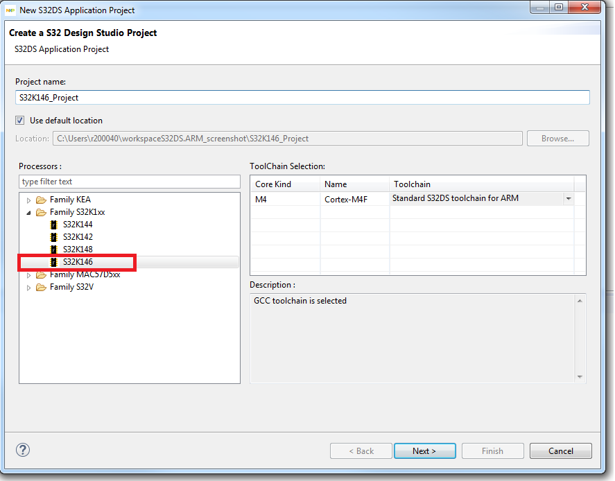

  • This update/service pack adds bareboard support for NXP S32K146 device into the S32 Design Studio for ARM v2.0

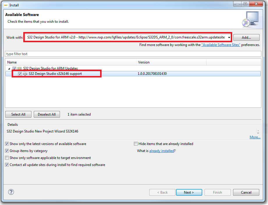

The update is available for online (Eclipse Updater) or offline (direct download link) installation.
select all available items and click "Next" button

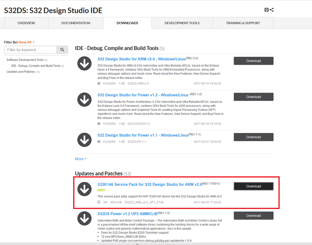

  • offline installation: go to S32 Design Studio product page -> Downloads section or use the direct download link to download the "S32 Design Studio for Power v1.2 - Update 2" file.

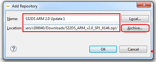

Start S32DS and go to "Help" -> "Install New Software..."
Add a new "Archive" repository and browse to select the downloaded Update 2 archive file:
Select all available items and click "Next" button.
This will starts the update installation.
