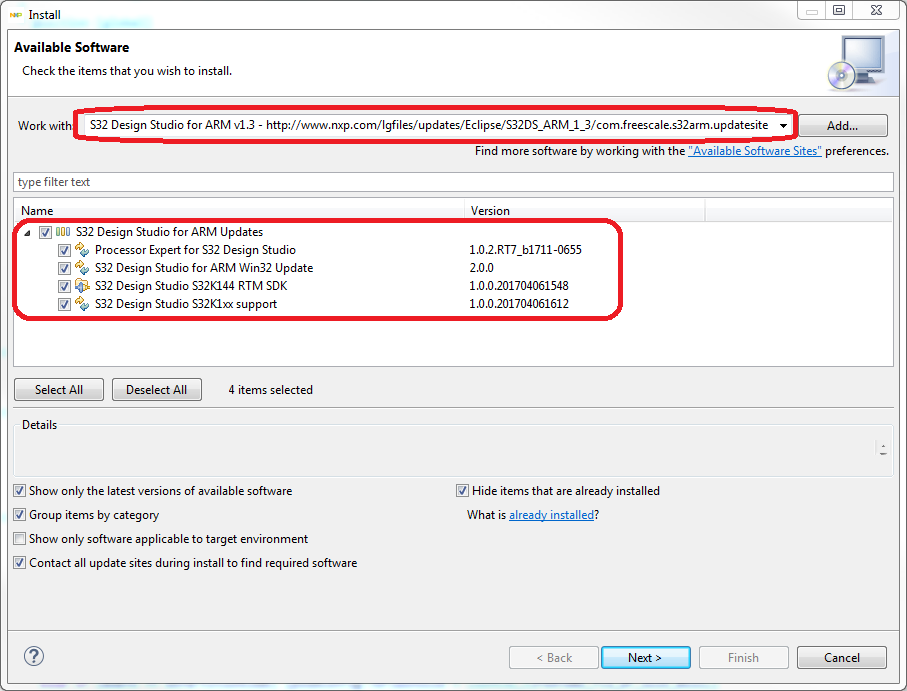

  • online installation: select predefined NXP S32 Design Studio update repository in "Help" -> "Install New Software..." dialog and proceed to installation.

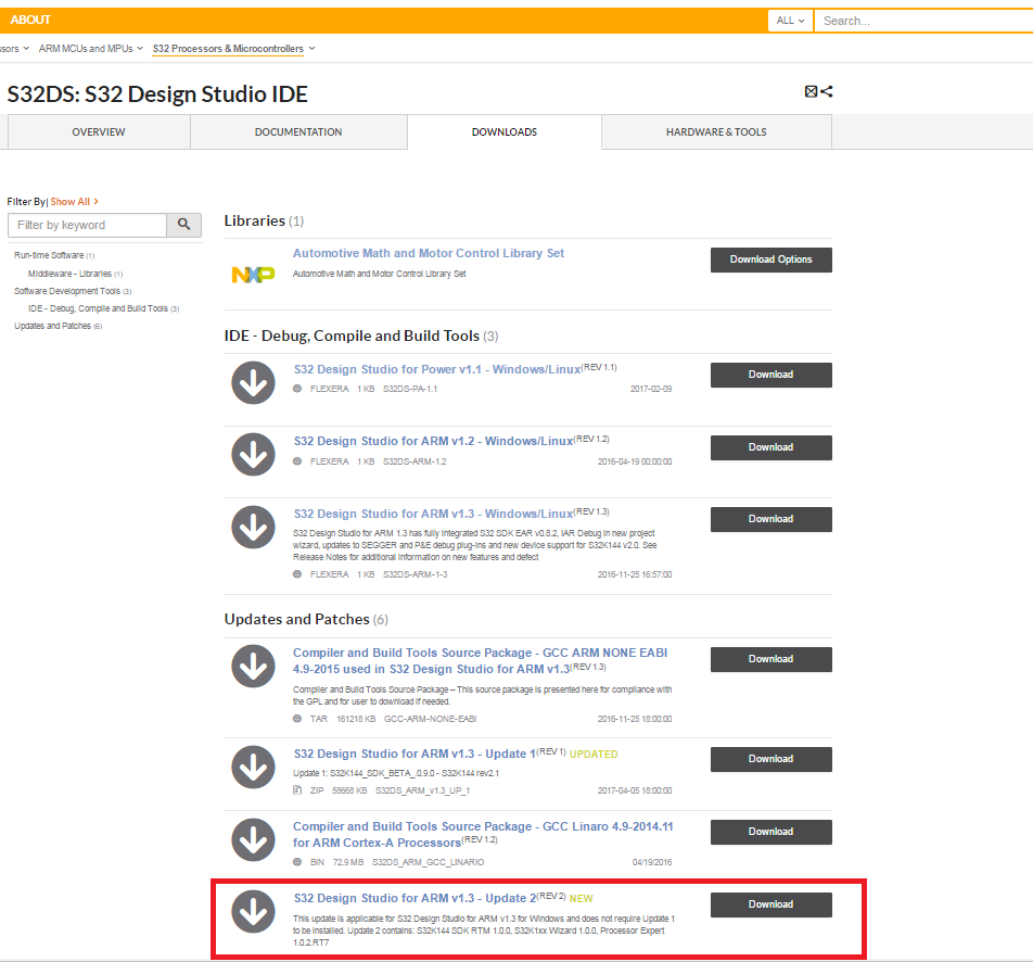

  • offline installation: go to S32 Design Studio product page -> Downloads section and download the "S32 Design Studio for ARM v1.3 - Update 2" file.

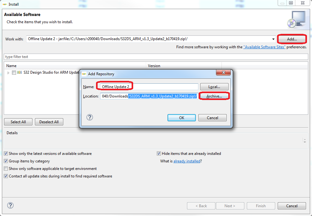

Start S32DS and go to Help -> Install New Software...
Add a new "Archive" repository, browse to select the downloaded Update 2 file.

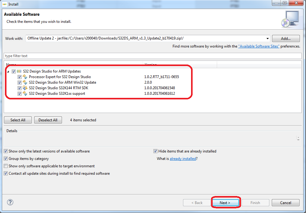

Tick all the update items and proceed to installation.
