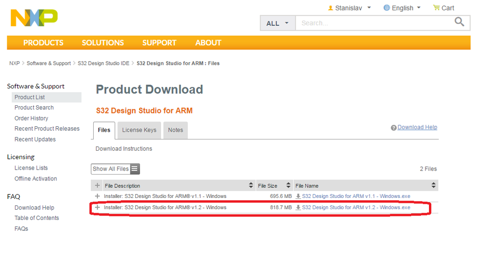

The new official release of S32DS for ARM v1.2 is available in the download section of S32DS web page: http://www.nxp.com/s32ds

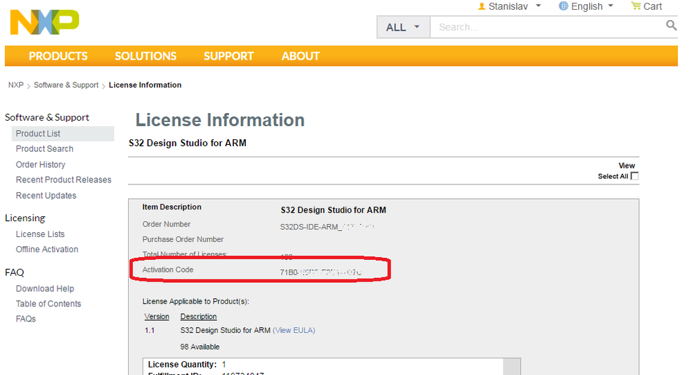

To  install the product the Activation Code is needed. You can Find it under "License keys" tab.
