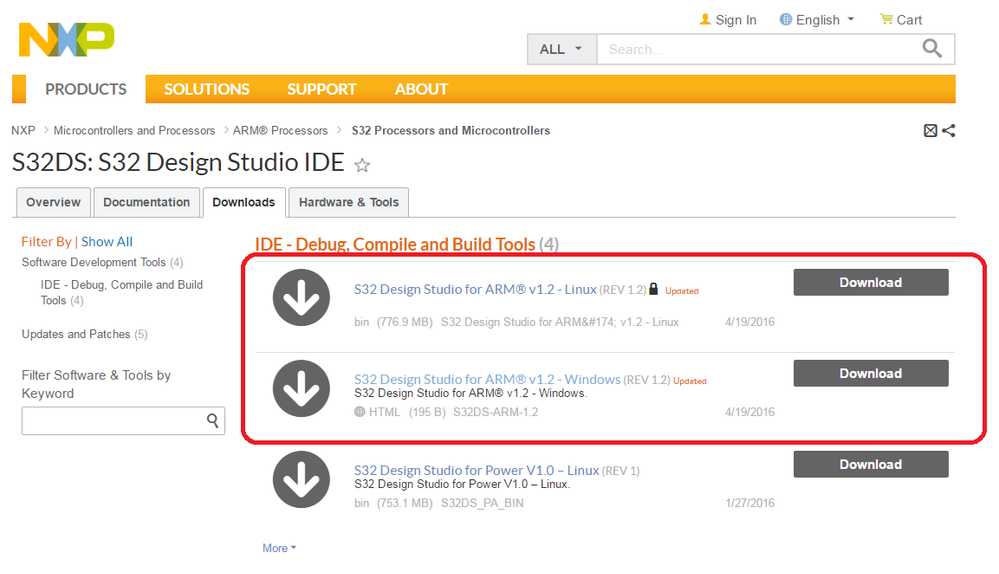

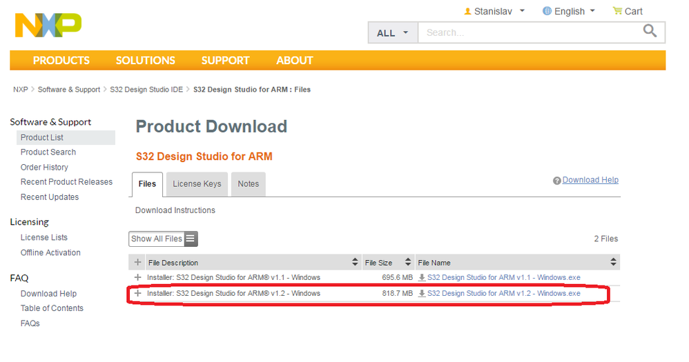

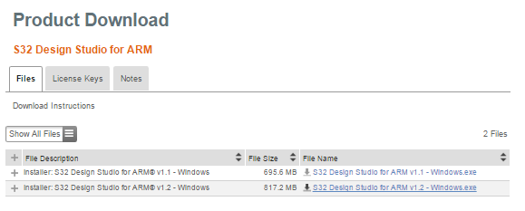

The new official release of S32DS for ARM v1.2 is available in the download section of S32DS web page: http://www.nxp.com/s32ds

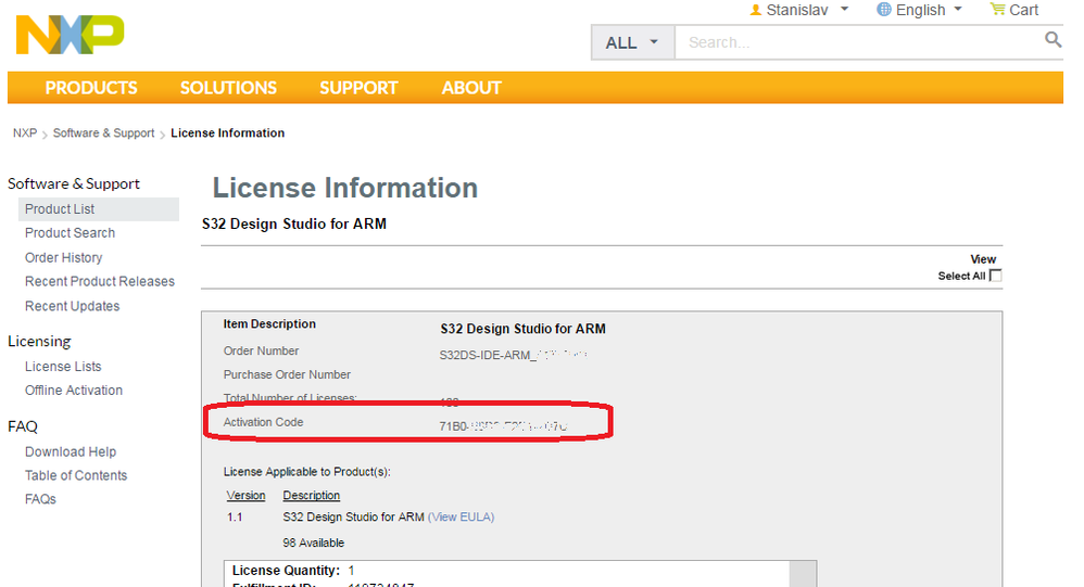

To  install the product the Activation Code is needed. You can Find it under "License keys" tab.

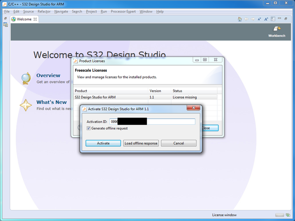

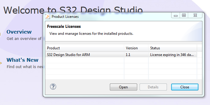

Hello Stanislav,
I am facing problem regarding licensing s32 Design studio v1.2.
I tried online and offline activation of license code I obtained in my mail, but failed in both modes.
I am unable to understand the reason for this.
For Offline Activation :
I get "Invalid offline response, Response Type" message in return.
For Online Activation :
Can you help me?
Thank you.
Hello Misal,
We apologize about the inconvenience.
I've reported this issue to our licensing team.
Now it should work.
Stan

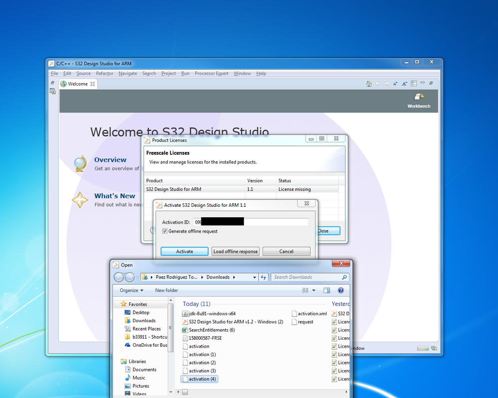

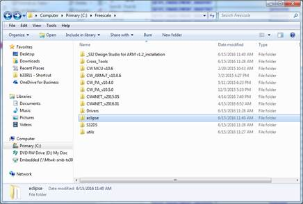

I found a workaround for this type of issues, that I think is related to the build installed
Here is what I did, I basically uninstalled the version I had install, and reinstalled with the recent build , here is the about S32
The build I got it from the web portal,  is the following
After uninstalling the S32 , and deleting trusted storage recorded on previous
In Windows 7, 8, Server 2008 and Server 2012 go to Start > Control Panel > Folder Options.
  1. 1. Click the View Tab.
  2. 2. Select the option to 'Show hidden files, folders and drives', and click OK.
Look for the following directory:
Windows XP and 2003 Server: C:\Documents and Settings\All Users\Application Data\FLEXnet
Windows Vista, 7, 8, Server 2008, Server 2012: C:\ProgramData\FLEXNet
I also deleted Eclipse folder located in the NXP location to avoid any previous plug in
After do this , I went to the fresh install and fo the following ,

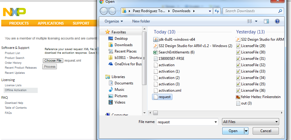

Save the request.xml , and load this file on the web portal offline activation
Save activation.xml and load this on the app, using load offline response
And now it works,
So with this , I will say the issue is on the build the user has , please make sure he is using our latest build
Hope this helps, thank you
