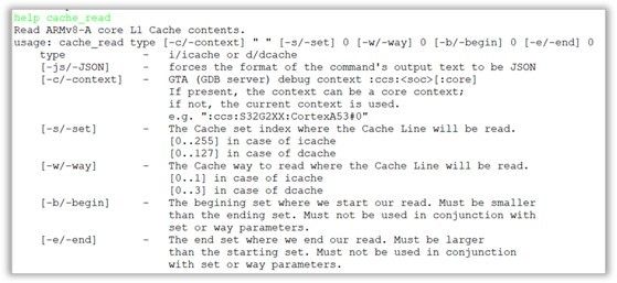

  • L1 Cache read capability for ArmV8-A.
