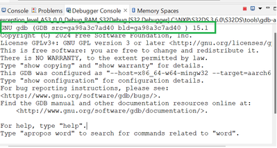

  • New GDB 15.1 for ARM cores

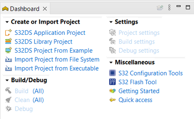

  • Improved Watch Registers view to expand all registers and export bitfields
  • Improved Dashboard view to include more options for quick access

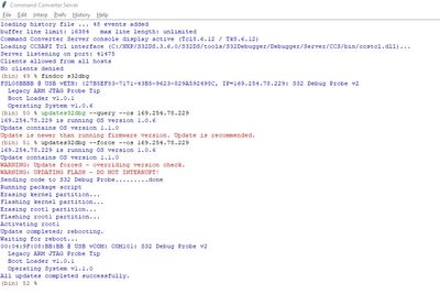

  • New S32Debug Probe OS version 1.1.0 update for resolving WiFi disconnect issue when the probe is connected via USB. Follow the HOWTO_Update_the_S32Debug_Probe_OS.pdf to update the probe firmware to the new version:

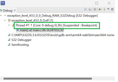

  • Expose current exception level in Debug View for ArmV8 cores:
  • New GDB version GDB 15.1 integrated for Arm cores with Python3 interpreter

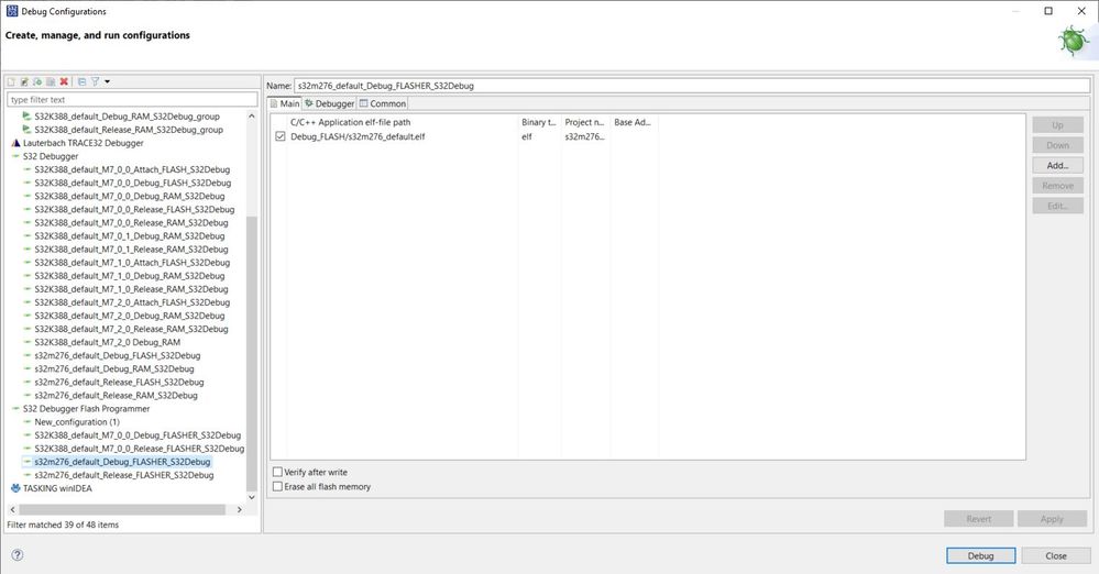

  • S32K3xx/S32M2xx/S32K14x:
    • S32K14x flash programmer support
    • Enhanced flash programmer to support also programming the Data Flash

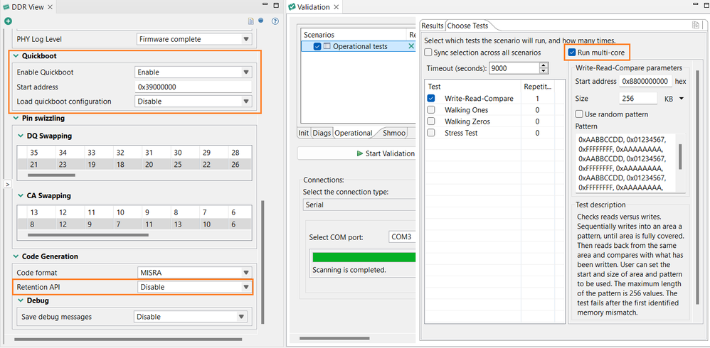

3.1 DDR features:
  • Intermediate progress report of memory test execution
  • Import log options
  • Access to LPDDR5 DRAM beyond 32bit address space
  • Quickboot, retention support and multicore test execution for LPDDR5

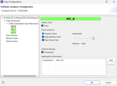

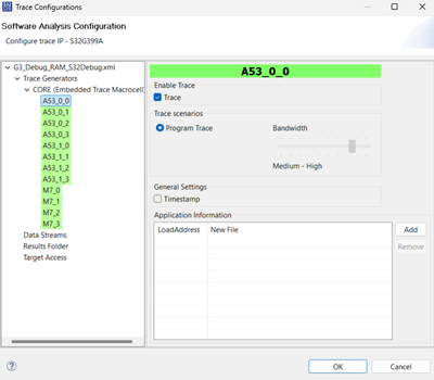

4. Major features for S32Trace 3.6.0
  • Added support for all S32G3 Family parts and application cores
  • Added support for Cortex-M7 cores for all S32G2 Family parts

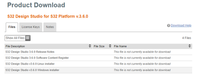

6. This release is available:
7. The installation instructions:

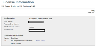

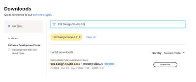

1. Navigate to S32Design Studio page on nxp.com and click Download
2. Login(if not) and Accept License Agreement.
3. Navigate to License Key tab and copy Activation Code
4. Launch S32Design Studio installer and when asked for Activation code, please provide the one from above step.
