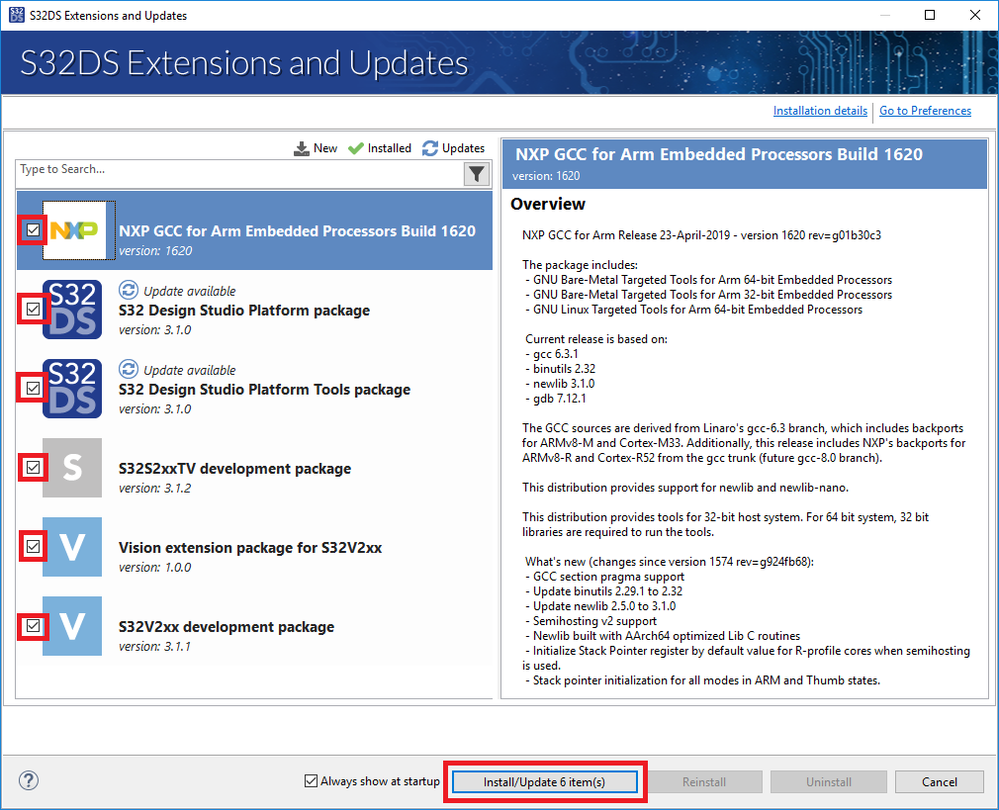

What is new?
  • S32 Design Studio Platform Package 3.1.2
  • S32 Design Studio Platform Tools Package 3.1.2
    • Updated S32 Debugger and S32 Flash tool to support S32S247TV
  • NXP GCC for Arm Embedded Processor build 1620
  • S32S2xxTV Development Package 3.1.2
    • Integrated S32 SDK EAR 0.8.0 for S32S (Windows only), S32 Configuration Tool IVT and DCD tools
  • S32V2xx Development Package 3.1.1
    • Integrated S32 SDK for S32V23x RTM 1.0.0 (Windows only)
  • Vision Extension Package for S32V2xx 1.0.0
  • This is a cumulative update - it is applicable to S32 Design Studio 3.1

  •  online installation:
    • go to menu "Help" -> "S32DS Extensions and Updates" dialog
    • select from available items and click "Install/Update" button

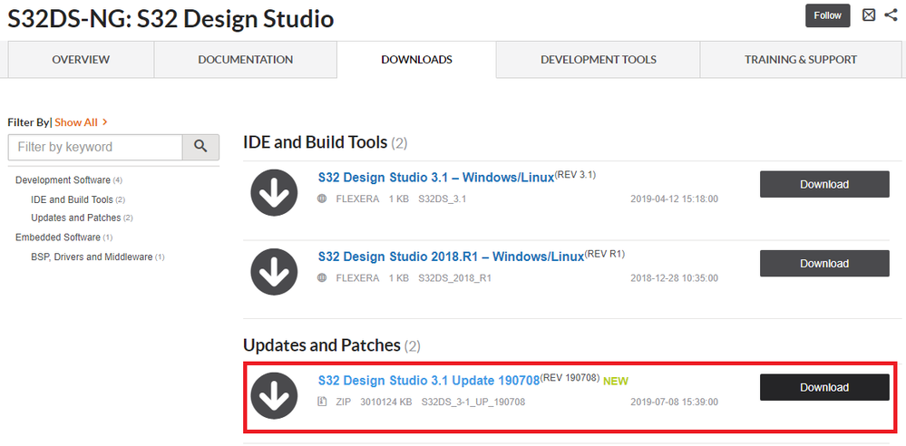

  • offline installation:
    • go to S32 Design Studio product page -> Downloads section or use direct link to download the update archive zip filepastedImage_2.png

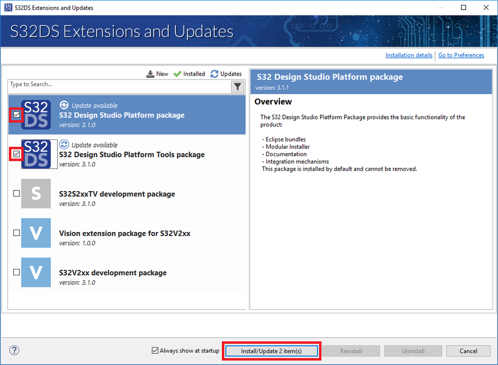

    • Start S32 Design Studio and go to "Help" -> "S32DS Extensions and Updates"pastedImage_12.png
    • Add a new "Add.." S32DS Software Site and browse to select the downloaded update archive .zip file you downloaded in the previous steppastedImage_6.png        pastedImage_5.png
    • Select from available items and click "Install/Update" button.
This will start the update installation process.
