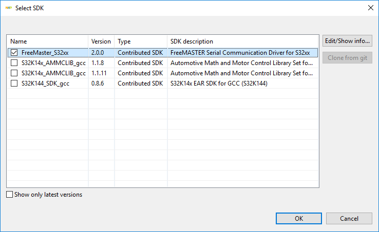

When creating a new S32DS Application Project, you may have noticed the FreeMASTER_S32xx SDK option in the Select SDK menu.
To add the FreeMASTER SDK to your project, simply add it in the New Project Wizard (as pictured above) or add it later through the project properties menu, SDKs:

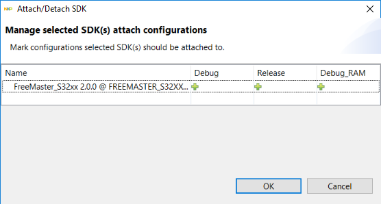

Select the desired SDK from the list, then click 'Attach/Detach...'
Click in the column for each build configuration for which you wish to have the SDK attached. You can remove SDKs by clicking the '+', making it disappear.

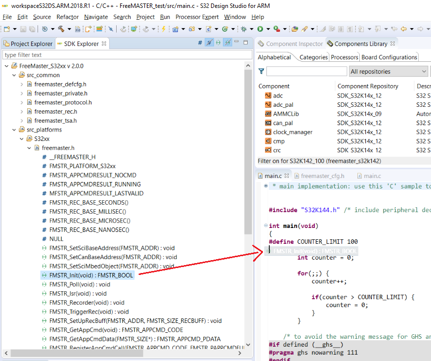

When working in your project, you can use the SDK Explorer to drag and drop macros and function calls into your code.

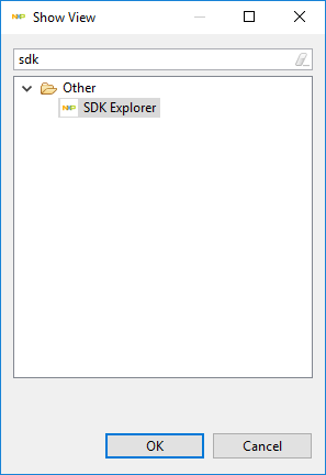

To add the SDK Explorer to your perspective, there are at least 2 methods:
1) Menu method
a) Window -> Show View -> Other... OR Alt + Shift + Q, Q
b) Filter on 'SDK'
c) Select 'SDK Explorer'
d) Click OK

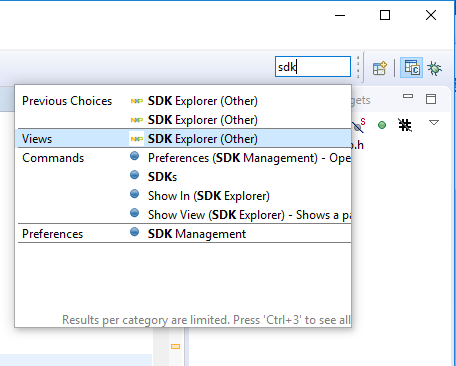

2) Quick Access method
a) Type 'SDK'
b) Select 'SDK Explorer'
To access the macros and function calls from the SDK Explorer:
1) Go to the Project Explorer and select your project to make it active.
2) Go to SDK Explorer and all of the SDKs you included in the project will be listed.
3) For the SDK you wish to access, expand the folders and files until you can see the function you wish to add. You can set some filters to hide unwanted content.
4) Simply drag and drop the macro/function call into your source file. The #include statement for the associated header file will be automatically added near the top of your source file.

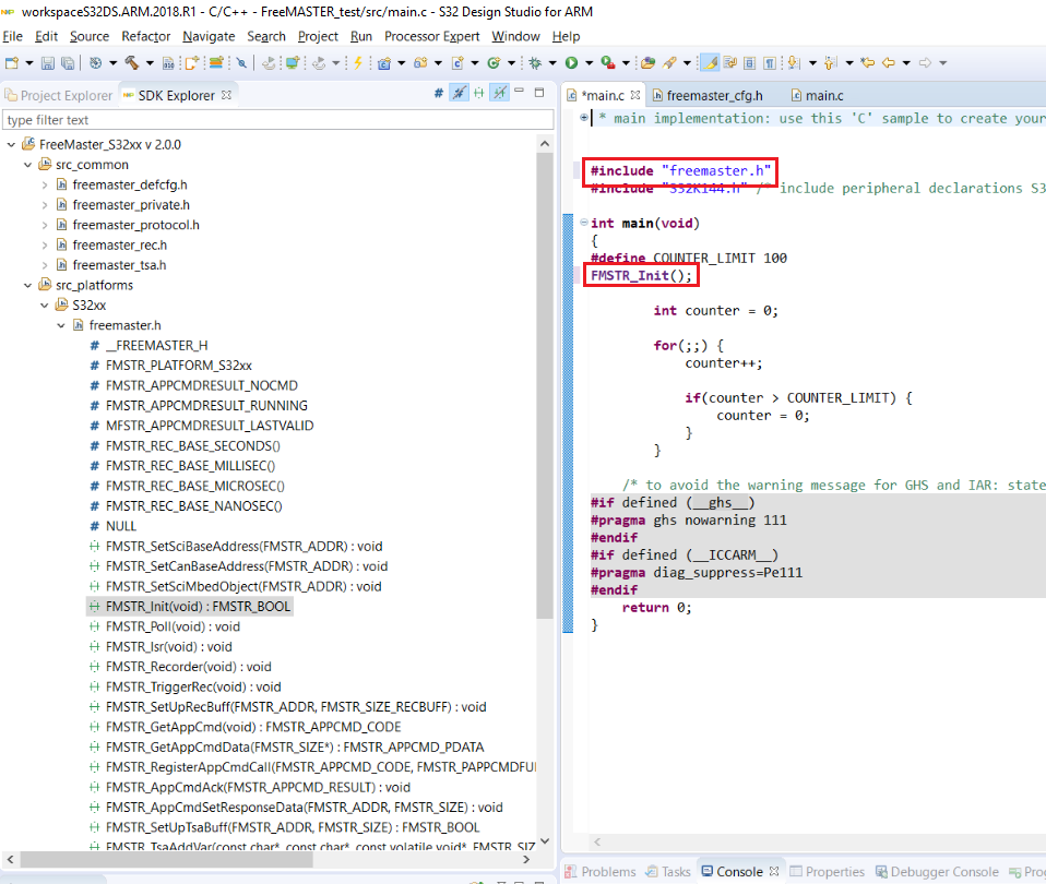

Hi Mike,
Thanks a lot for the introduction of FreeMaster.
I tried to add the freemaster component in my current project with s32K142 processor. but i can't finde the freemaster sdk in project properties window. see pic below. It seems that the freemaster ist not supported for S32K142 but i can still find a example names freemaster_s32k142 under new project from example.
could you please help me to figure out how can i add this component in my owm project ?
Baoyuan
Hello [email protected],
As you have discovered. the S32K142 is not supported by the FreeMaster_s32xx SDK. This means that it will be necessary to integrate the FreeMaster Serial Commuication Driver manually. This is what the example 'freemaster_s32k142 demonstrates. It shows you an example of an application project with the driver integration completed and functional.
You already have all of the files you need, they are located in the following directories:
C:\NXP\S32DS_ARM_v2018.R1\S32DS\FreeMASTER_Serial_Communication_Driver_V2_0\src_common
C:\NXP\S32DS_ARM_v2018.R1\S32DS\FreeMASTER_Serial_Communication_Driver_V2_0\src_platforms\S32xx
You should also see the application note on FreeMASTER Serial Driver Usage: https://www.nxp.com/docs/en/application-note/AN4752.pdf
Hope it helps,
Mike
