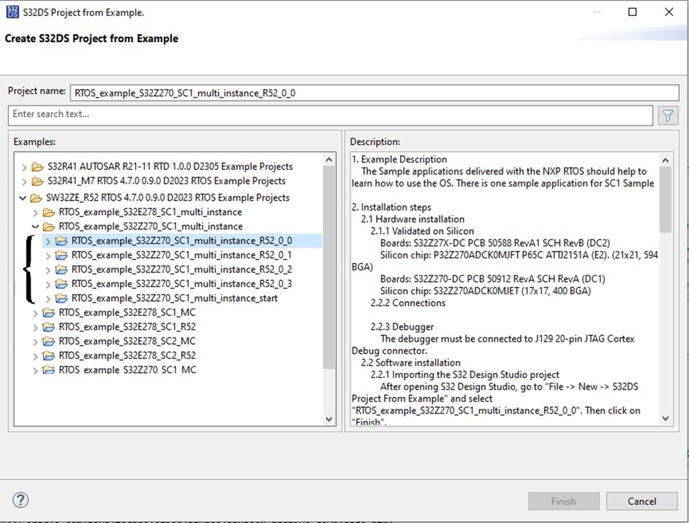

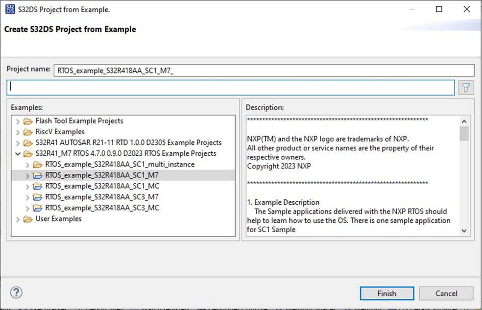

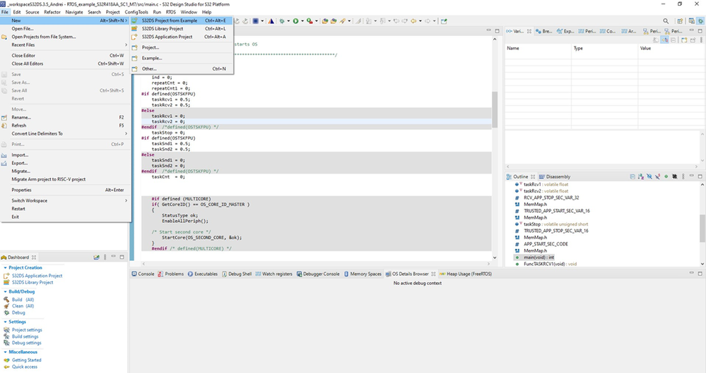

  • While in Design Studio, go to File -> New -> S32DS Project From Example  and select one of the existing single core S32 Design Studio Sample applications delivered with the NXP RTOS or import your own S32 Design Studio project.
  • Select the desired project from the list of examples and click finish

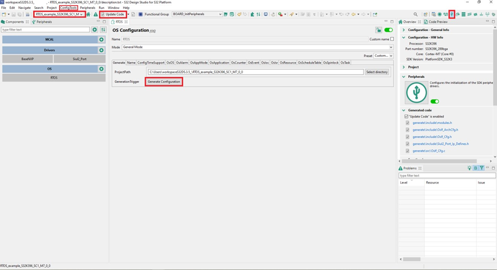

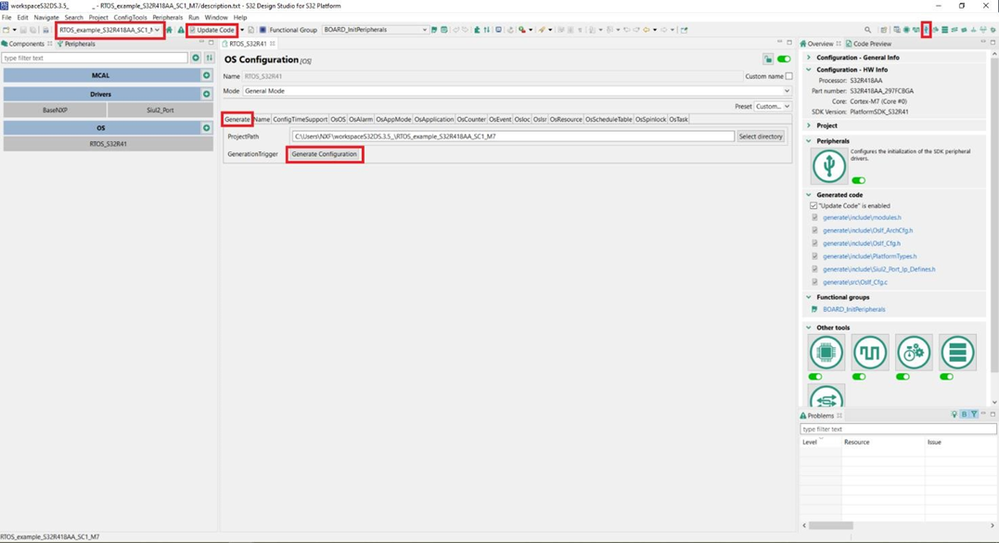

Generating configuration

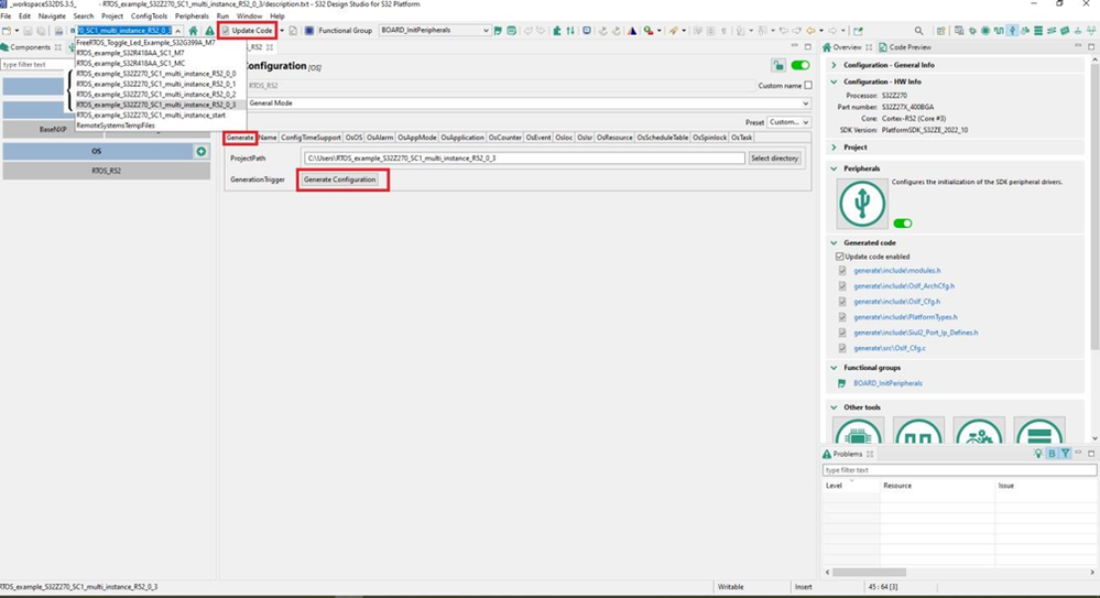

Before running the example, a configuration needs to be generated. First, go to Project Explorer View in S32 Design Studio and select the current project.
Right click and select the "S32 Configuration Tool" menu then click "Open Peripherals".
 Click on the "Update Code" button.
Click on Select directory under "Generate" field to select the directory which contains example project (E.g.: D:\WorkspaceS32DS\RTOS_example_S32R418AA_SC1_M7) then click on Generate Configuration.
Click "Update Code" again.

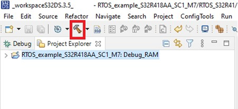

Building the project
Select the project in the S32 Design Studio Workspace and click on Build. Clicking this button will start the build using the preset build type.

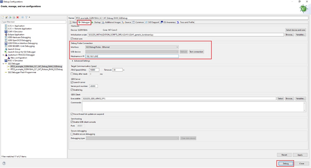

Debug configuration
Click on Debug Configurations
Setup the Debug Probe Connection for the project. Select either USB or Ethernet, depending upon your hardware setup. If USB is selected, the COM port for the S32 Debug Probe will automatically be detected (unless not connected or more than one probe is connected). If Ethernet is selected, then enter either the hostname (fsl + last 6 digits of MAC address) or IP address. See
‘S32_Debug_Probe_User_Guide.pdf’
({S32DS_installation_directory}/S32DS/tools/S32Debugger/Debugger/Docs/S32_Debug_Probe_User_Guid e.pdf) for more details on the setup of the S32 Debug Probe.

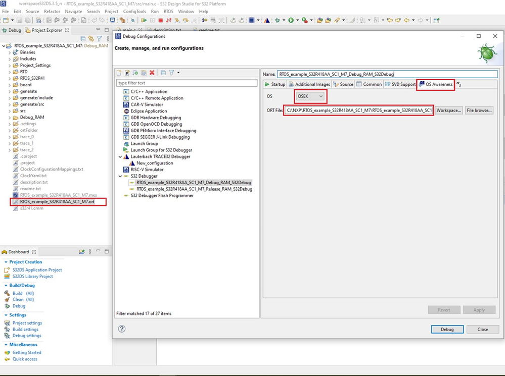

Loading the ORTI file and starting debug

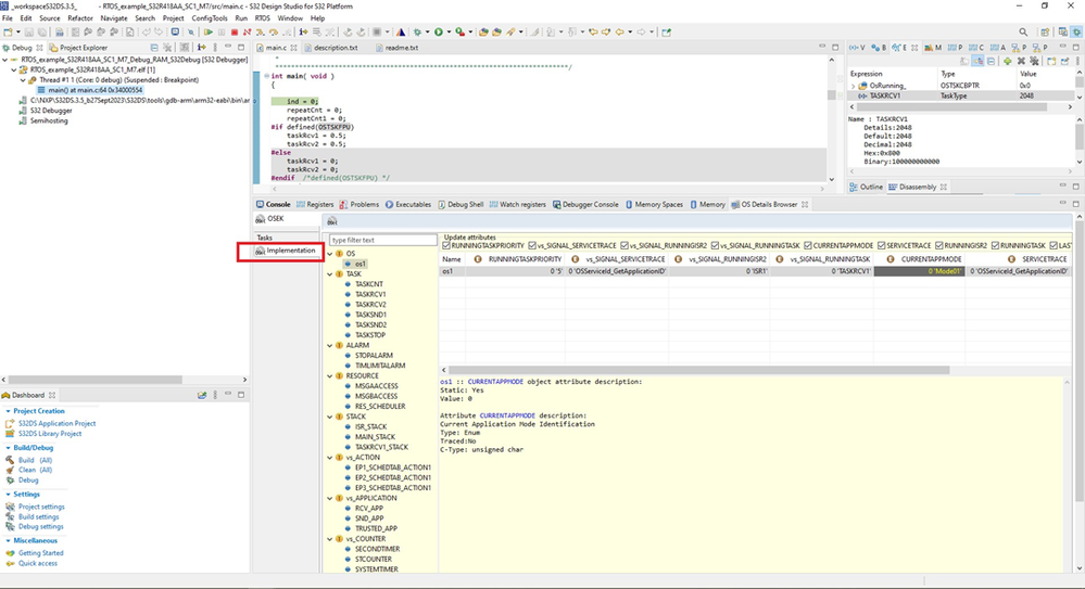

From the OS Awareness tab select “OSEK” from the OS dropdown list. Browse and select from local system or Workspace the required *.ort file Click the Debug button.

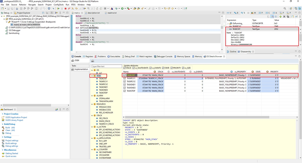

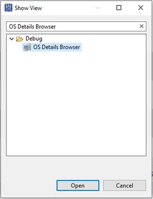

OS Details Browser view
Navigate to go to Window -> Show View -> Other…  and select the OS Details Browser view

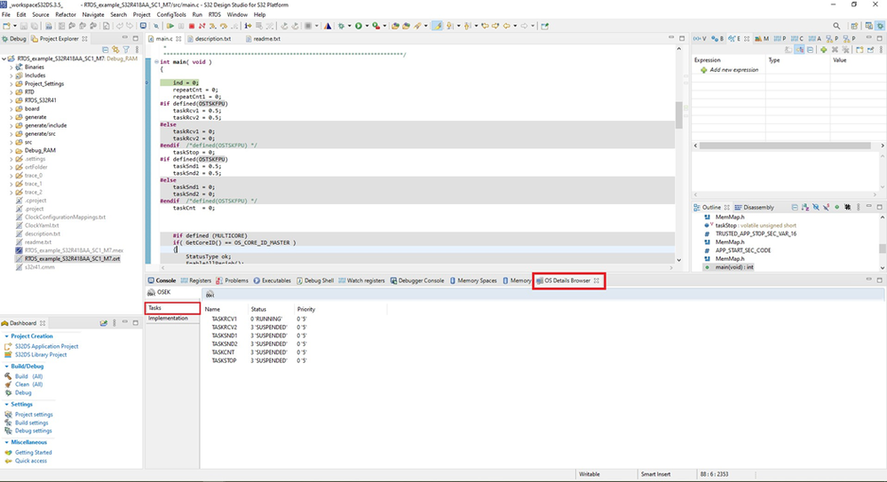

Using the OS Details Browser view, Design Studio can display information about the tasks status on the target.
Tasks tab
In the “Tasks”  tab from the OS Details Browser view you can see information about the operating system (the number of tasks, current task states, system objects):

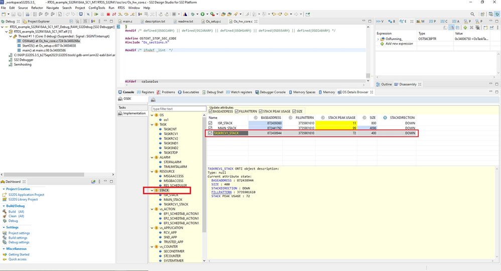

Implementation tab
Switch to the “Implementation” tab to see more detailed information gathered from the .ort file:
  • OS – current state
  • Tasks – priority, state and assigned stack
  • Stacks – usage and attributes
  • Other OS resources defined and declared through ORTI
  • Detailed info about ORTI data object
  • Customize data presentation (HEX format, re-arrange the table columns)
  • Colored presentation of data: -   White fields are static
    • Blue fields are non-static
    • Yellow fields are fields that changed their values from the last time they were inspected/checked.
  • OS information:
  • Tasks information:
  • Stacks information:

Project setup
Go to File -> New -> S32DS Project From Example  and select one of the existing multi-core S32 Design Studio Sample applications delivered with the NXP RTOS or import your own S32 Design Studio project.

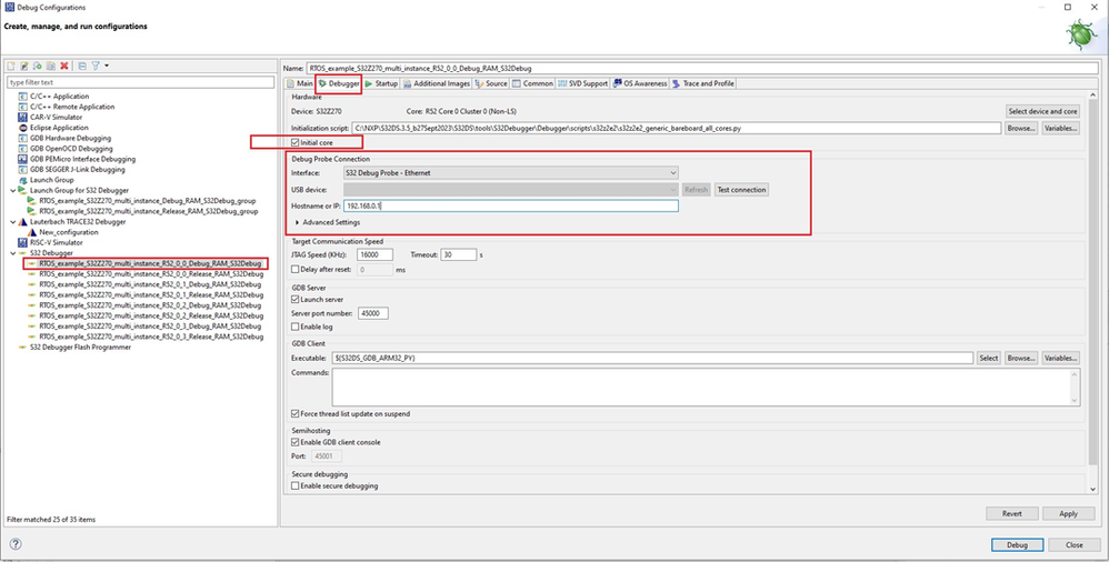

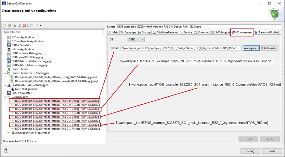

Debug configuration
Click on Debug Configurations.
Click the initial core under S32 Debugger in Debug configurations menu.  Setup the Debug Probe Connection.
Loading the ORTI file must be done for all the project configurations:
  • RTOS_example_S32Z270_SC1_multi_instance_R52_0_0
  • RTOS_example_S32Z270_SC1_multi_instance_R52_0_1
  • RTOS_example_S32Z270_SC1_multi_instance_R52_0_2
  • RTOS_example_S32Z270_SC1_multi_instance_R52_0_3

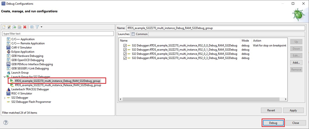

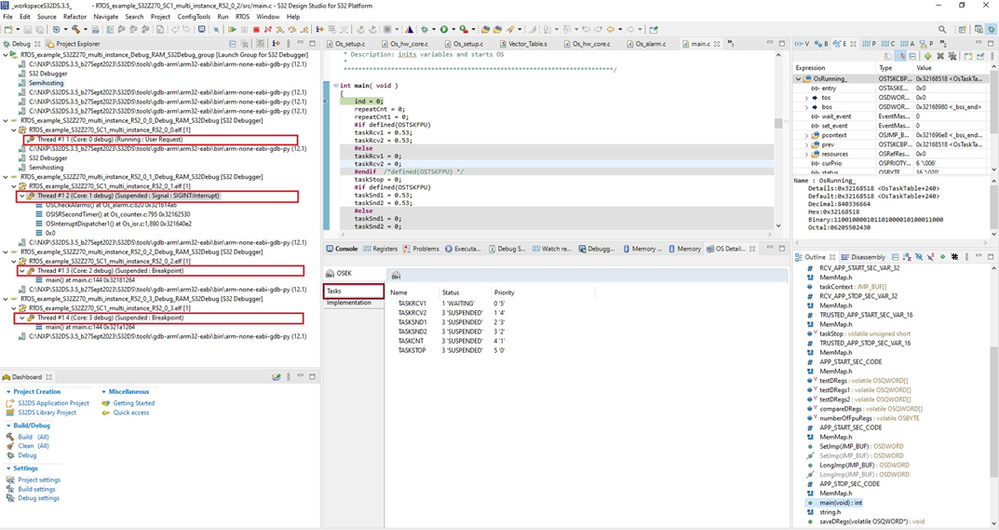

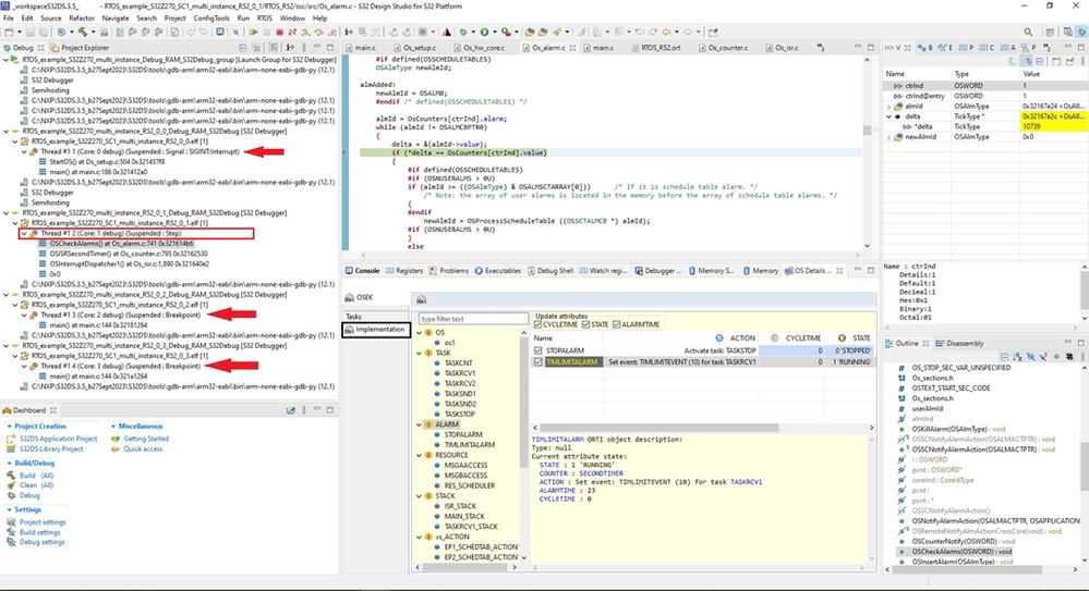

From the Debug Configuration menu, click on Launch Group for S32 Debugger. Check all the cores that you want to debug. Click the Debug button.
Compared with single core projects, when debugging multi core projects you can switch between the debugging sessions and information from all debugged cores
Tasks tab
Implementation tab
The information displayed in Implementation tab is the same as in single-core projects case, but you can switch between the debugged cores

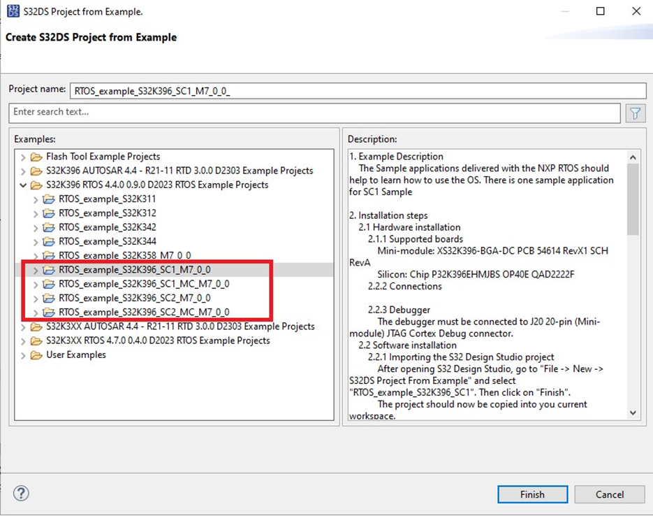

Select the desired project from the list of examples delivered with PE Micro Debug probe support or import your own S32 Design Studio project and click finish For this How To Guide, RTOS_example_S32K396_SC1_M7_0_0 was used

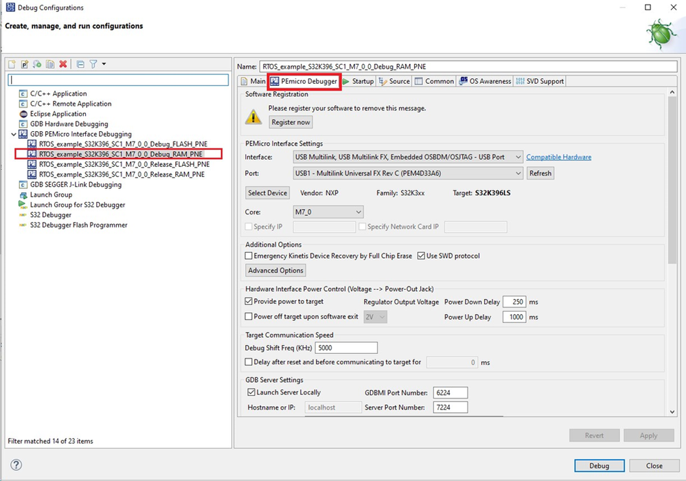

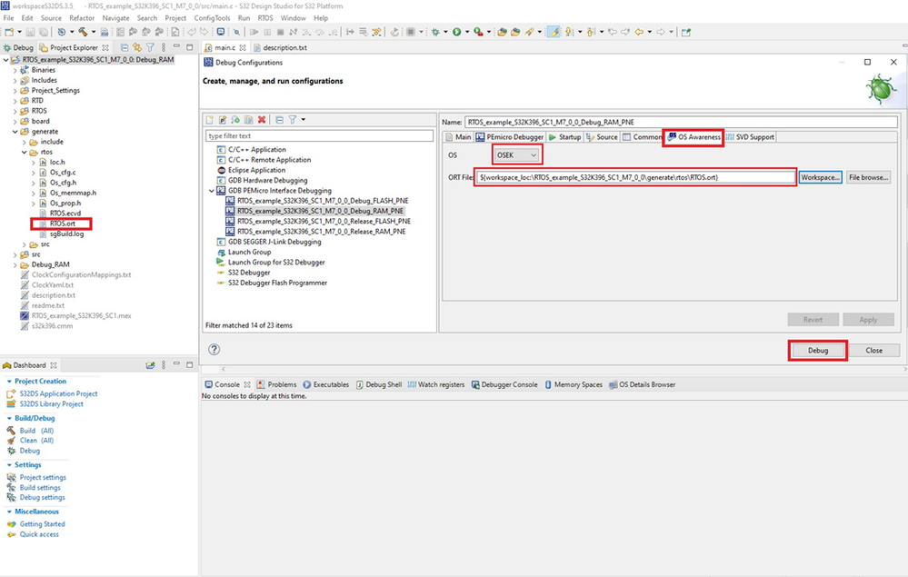

Debug configuration
Select the debug configuration associated with your current build configuration and click on the “PEmicro Debugger” tab. Verify proper interface and port and if the device is properly detected.
