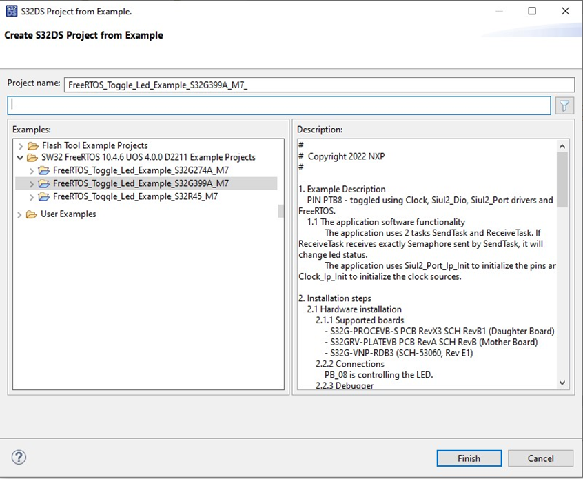

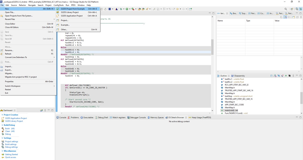

While in Design Studio, go to File -> New -> S32DS Project From Example  and select one of the existing single core S32 Design Studio Sample applications delivered with the NXP FreeRTOS or import your own S32 Design Studio project.
Select the desired project from the list of examples and click finish

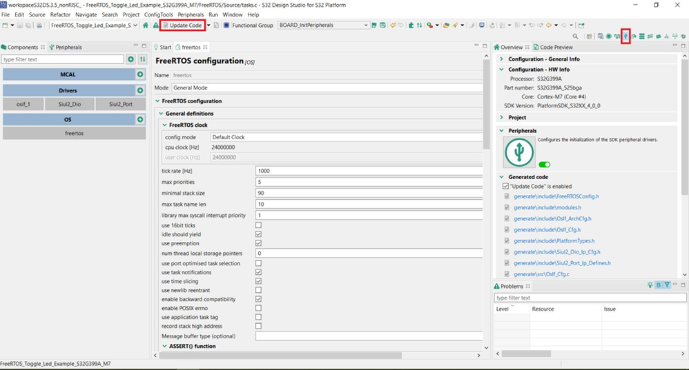

Generating configuration
Before running the example a configuration needs to be generated. First go to Project Explorer View in S32 Design Studio and right-click the current project.
        Select the "S32 Configuration Tool" menu then click on the desired configuration tool (Pins, Clocks, Peripherals etc...).
        Clicking on any one of those will generate all the components. Make the desired changes (if any) then click on the "S32 Configuration Tool → Update Code" button.

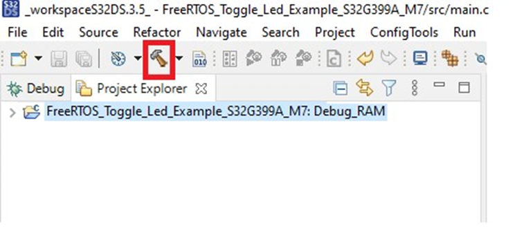

Building the project
Select the project in the S32 Design Studio Workspace and click on Build. Clicking this button will start the build using the preset build type.

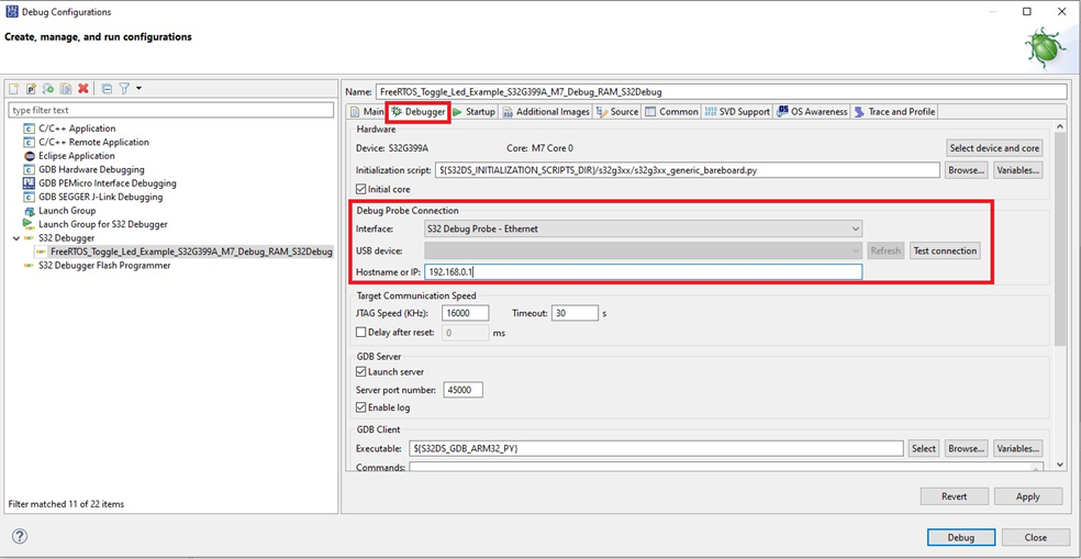

Debug configuration
Click on Debug Configurations
Setup the Debug Probe Connection for the project. Select either USB or Ethernet, depending upon your hardware setup. If USB is selected, the COM port for the S32 Debug Probe will automatically be detected (unless not connected or more than one probe is connected). If Ethernet is selected, then enter either the hostname (fsl + last 6 digits of MAC address) or IP address. See
‘S32_Debug_Probe_User_Guide.pdf’
({S32DS_installation_directory}/S32DS/tools/S32Debugger/Debugger/Docs/S32_Debug_Probe_User_Guid e.pdf) for more details on the setup of the S32 Debug Probe.

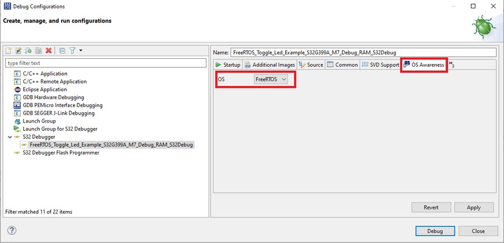

Selecting FreeRTOS OS Awareness and starting debug
From the OS Awareness tab select “FreeRTOS” from the OS dropdown list and click Debug.

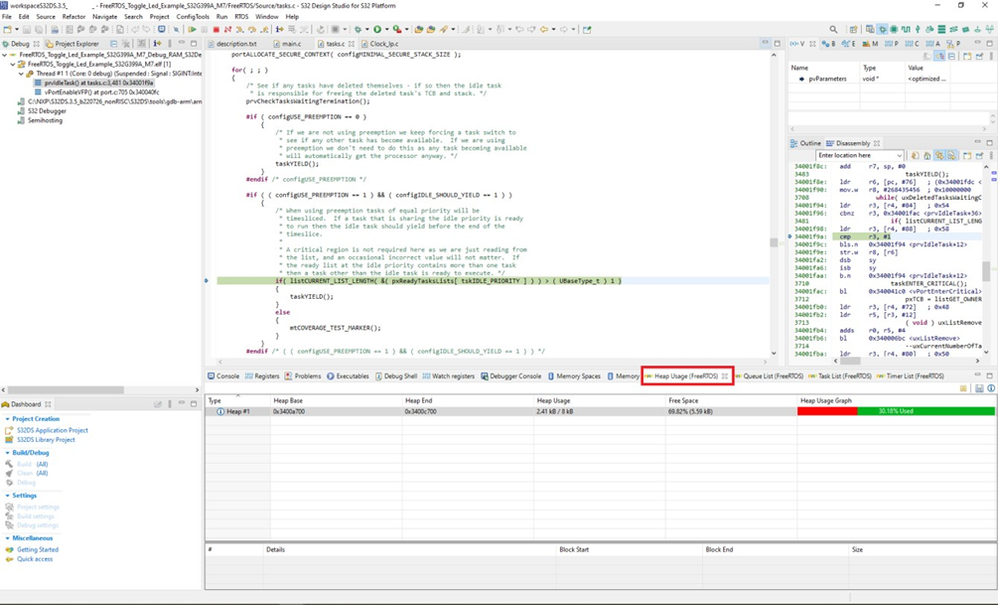

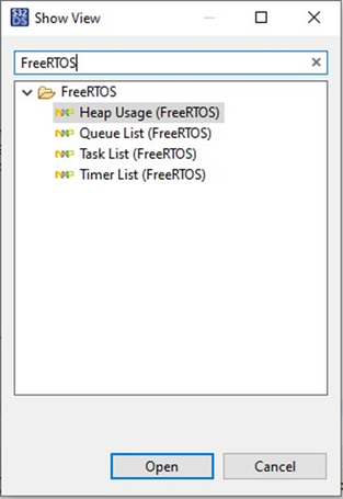

FreeRTOS views
Navigate to go to Window -> Show View -> Other…  and select the FreeRTOS view
Using the Heap Usage, Queue List, Task List and Timer list views, Design Studio can display information about the tasks status on the target.
Heap usage view

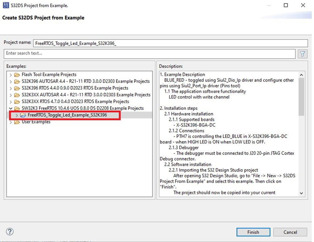

Go to File -> New -> S32DS Project From Example
Select the desired project from the list of examples delivered with PE Micro Debug probe support or import your own S32 Design Studio project and click finish

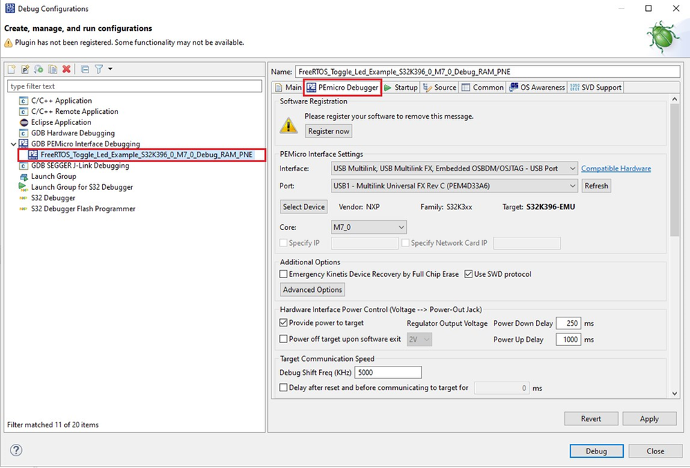

Select the debug configuration associated with your current build configuration and click on the “PEmicro Debugger” tab. Verify proper interface and port and if the device is properly detected.

FreeRTOS views
