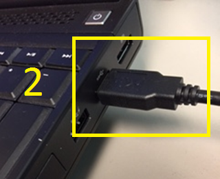

Before you can start debugging an S32DS for Vision project for S32V234 Cortex-A53 APEX2/ISP Linux target on the S32V234-EVB, we must first setup the hardware connections and start the Linux BSP OS.
1) Connect (1) S32V234 USB Micro B port to (2) USB A port on your PC. This allow you to connect to the Linux BSP OS via a terminal program to issue commands and to obtain the IP address.
2) Insert microSDHC card (with U-boot, Linux kernel, devicetree, and root file system loaded*) into (3) the S32V234 SD card slot

Thank you Mike! I have another question now. I was preparing the board as below. When I got to step 3, I didn't get any infromation that the drivers have been installed, also the LED of UART0 was off. I prepared the SD card as the guide said and installed VSDK on my laptop. Could you tell me what might be the problem? Is it the microUSB cable that I used or the SD card was not prepared well? Thanks a lot in advance.steps.PNG

Please ensure the HW is connected to the power supply and the power is switched on. The SD card does not matter for the Windows OS on the PC to detect a connection to the USB port on the EVB. Could you see the USB connection in the Windows Device Manager?
If you are using the S32 Design Studio, please ensure you are using v3.1. The version 3.2 does not yet support the Vision Extension Package. Also, you need to be sure to use the BSP contained within the Vision SDK v1.3, which was installed with S32 Design Studio v3.1. If you install a newer BSP to the SD card vs the version of Vision SDK you are using, then it will not work.

I can't see it in windows device manager or terminal program, I tried two different USB-MicroUSB cable but still the same result, should I use certain type? Thanks in advance.

While the S32DS for Vision 2018.R1 should work, I highly recommend that you instead use the S32 Design Studio v3.1. Our support for S32V devices will be included through the 3.x versions. Please note, it is v3.1 and NOT v3.2 you should use. We have not yet provided an updated release for the S32V support within v3.2. When we do provide this update, then you will want to move to the v3.2 release and take the new S32V package. It will support the latest VSDK release at this time as well. For now, it is just the S32 Design Studio v3.1 and then install the 'S32V2xx development package' (v3.1.1) and the Vision extension package for S32V2xx' (v1.0.0). This uses the VSDK v1.3.
As for the HW connection issue, I have had some issues with the USB connection, but it is generally after some extensive use. Is the connection of the microUSB on the EVB a good one or does it seem to not fit well? If it does not fit well, then perhaps it is not making good connection. I hope this is not the issue you are having, but it is worth the effort to check.
At a minimum, when you connect the USB cable, you should see LED D16 flash a few times. It is red color. For me, when I connect it, WIndows incorrectly identifies it as a Mouse, as you can see below, but it still is assigned a COM port and so I can then connect with the terminal program.

Thank you so much for these detailed explanation. I installed the version as you said and found one cable which works, so now I can run the demo on my board.
