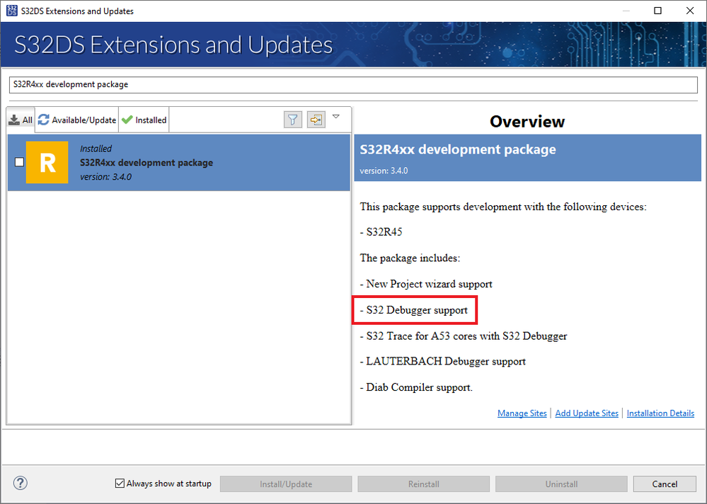

  2. Install the Development Package for the device you are debugging. This is important as the S32 Debugger support within it contains the device-specific Python scripts required for initialization of the cores.

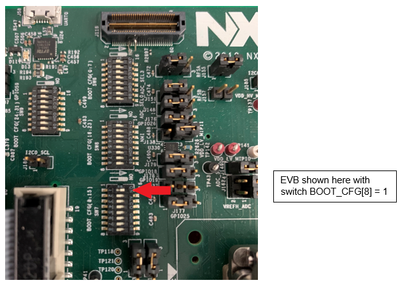

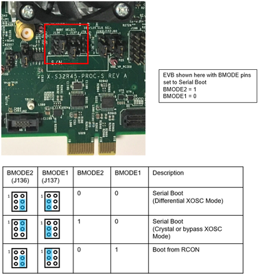

  4. Set BMODE pins to Boot from RCON
  5. Set BOOT_CFG[8]=1 on the S32R EVB, for serial RCON mode
    See the EVB documentation and device reference manual for more details on BOOT_CFG settings, etc.

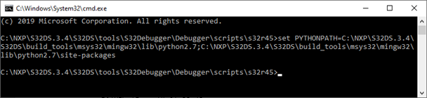

  2. Set Python path so correct version is used (if not already set in env vars)
    set PYTHONPATH=C:\NXP\S32DS.3.4\S32DS\build_tools\msys32\mingw32\lib\python2.7;C:\NXP\S32DS.3.4\S32DS\build_tools\msys32\mingw32\lib\python2.7\site-packages

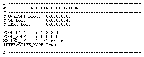

  3. Edit the python script to adjust the value to be programmed to RCON, s32r45_i2c_RCON.py. Note: The listed examples show only the minimum values required to configure each of the external memory types. Additional settings may be required for your specific application.
    1. Adjust the RCON_DATA for the configuration you wish to program.
    2. Do not adjust RCON_ADDR.
    3. Adjust the S32DBG_IP for the IP address of your S32 Debug Probe.
    4. Adjust the INTERACTIVE_MODE
      1. Set True, if desired to be prompted in the command window to enter RCON_DATA
      2. Set False, if desired to have script automatically enter RCON_DATA, based on the value set within the file.

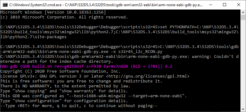

  4. Enter the command to start GDB, passing in the RCON Python script:
    Windows OS: C:\NXP\S32DS.3.4\S32DS\tools\gdb-arm\arm32-eabi\bin\arm-none-eabi-gdb-py.exe -x s32r45_i2c_RCON.py
    Linux OS: arm-none-eabi-gdb-py -x .\s32r45_i2c_RCON.py

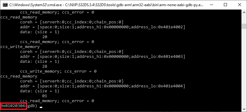

  5. You may need to press enter a couple of times. If everything worked properly, then the value you programmed will be displayed to the screen.
  6. To exit GDB, enter 'quit'.
  7. Before performing boot from serial RCON, remember to set BOOT_CFG[8] = 1. See the EVB documentation and device reference manual for more details.
