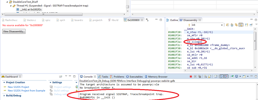

If the linker script file is not updated and the linker warnings are ignored you may experience an exception at the runtime - typically when __init routine is executed. Missing .init section causes that an invalid instructions is fetched and causes the core IVOR exception.

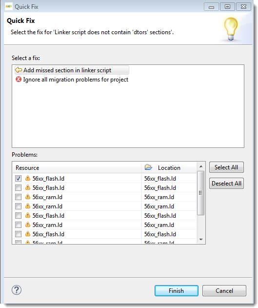

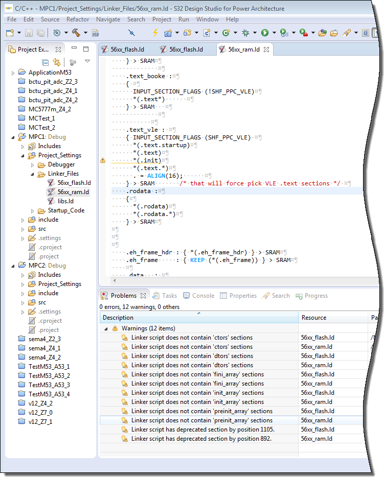

If you import and build an older project in S32DS Power v1.2 the linker issues these linker script related warnings:
Right click on the warning and select Quick Fix:
Select "Add missed section in linker script" + "Select All" and press "Finish".
Repeat these steps until all the linker script warnings disappears.
