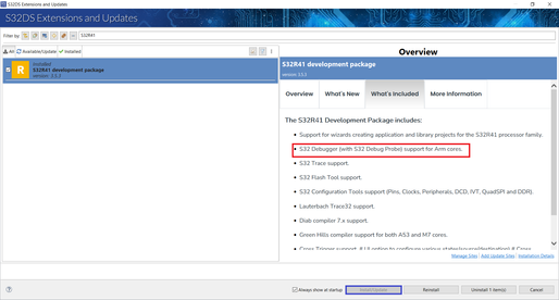

  2. Install the Development Package for the device you are debugging. In this case, the S32R41 development package. This package is important as the S32 Debugger support component contains the device-specific Python scripts required for initialization of the cores.

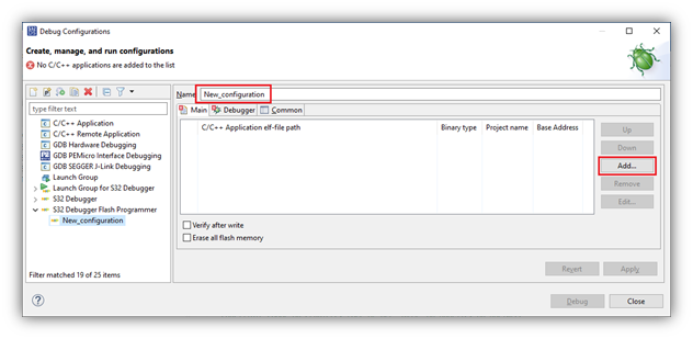

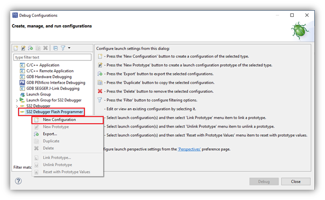

  1. Open Debug Configuration menu
  2. Select 'S32 Debugger Flash Programmer', then right-click and select New.

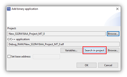

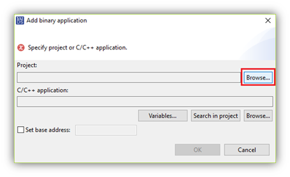

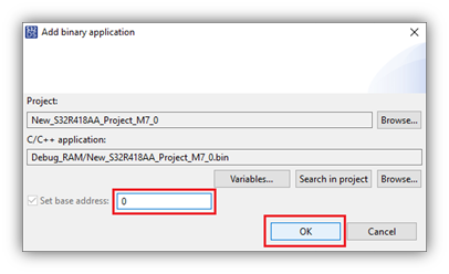

  3. Enter an name for the new configuration and click Add... to add the file to be flashed.
  4. Click Browse... to select the project from the workspace where the application binary is located
  5. Select the project and click OK

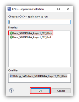

  6. By default, the ELF file is found. Click Search in project to select the binary file.
  7. Select the .bin file and click OK

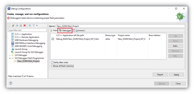

  8. Now we must enter the base address. Typically, this could be 0, but you may have other requirements. Click OK.

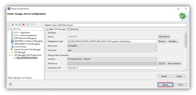

  9. Now we are ready to configure the debugger connection settings. Click on the Debugger tab.

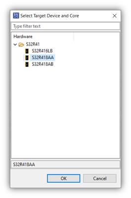

  10. Starting from the top and working our way down, click on Select device.
  11. Select the device and click OK
  12. The correct Initialization script will automatically be set. Set the Debug Probe Connection settings to match your setup. When done, click Applyimage.png

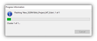

  13. To start the flashing, click Debug

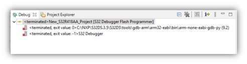

  14. Flashing progress will be displayed.
  15. When complete, the Debug perspective will show at terminated thread.
