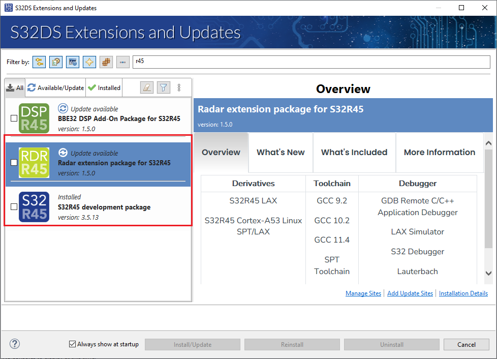

  1. Setup the software tools
    1. Install S32 Design Studio for S32 Platform
    2. Install the S32R4xx development package and the Radar extension package for s32R4xx. Both of these are required for the SPT accelerator.

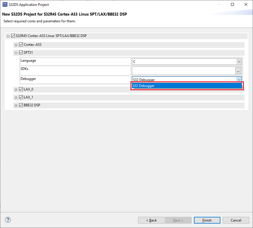

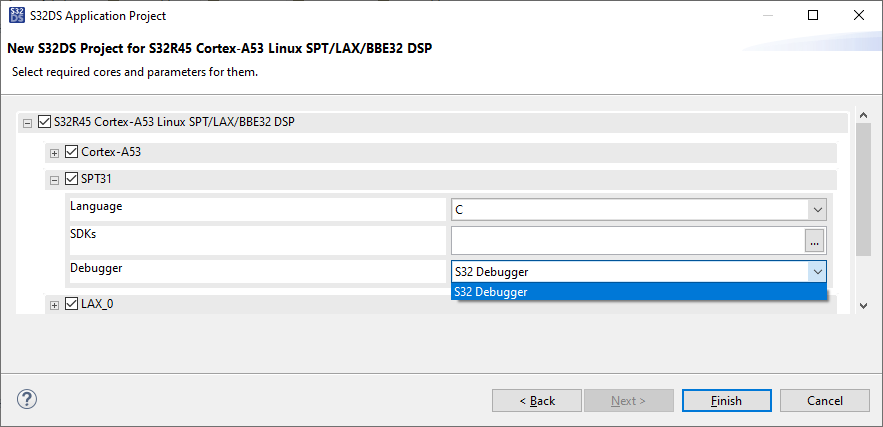

  4. Open existing project or create a new project and check that it successfully builds. If creating a new project, be sure the S32 Debugger is selected in the New Project Wizard.

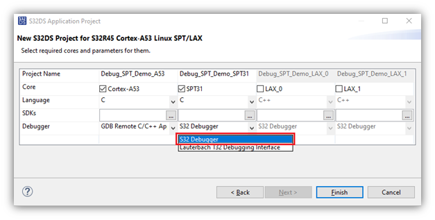

If the New Project Wizard was used to create the project using the S32DS Application Project option, then there was an opportunity to select the desired debugger from within the wizard. If the desired debugger option was selected at this time, then the needed configuration already exists and will only require adjustments to the hardware connection settings.
If the New Project Wizard was not used to create the project OR the currently desired debugger was not the one selected at the time of project creation, a new debug configuration must be created.

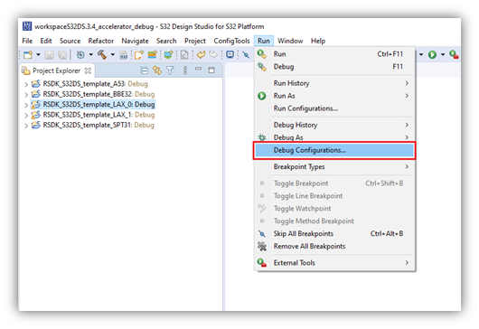

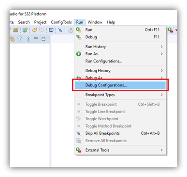

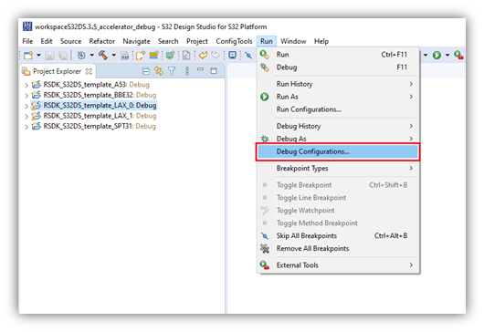

  1. With the existing project selected in Project Explorer, open the Debug Configurations Menu: Run -> Debug Configurations
    Having the existing project selected in the Project Explorer view will make the creation of a new launch configuration easier as many settings will be imported from the selected project. To select a project, click on it so it becomes highlighted.

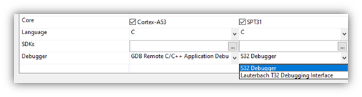

  2. Next, select the debugger for which the new debug configuration will be created.
  3. To create the new configuration, either click on the ‘New launch configuration’ button from the toolbar at the top and to the left, or right-click on the ‘S32 Debugger’ and select ‘New Configuration’ from the menu.

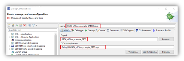

  4. Once the configuration is created it will be displayed and any errors with the configuration will be shown. If the project was selected in the Project Explorer, then the Name of the debug configuration will contain the project’s name and the Project and C/C++ Application fields will be populated as well. The C/C++ Application field will only be populated if the build output executable exists. Confirm these values are correct before moving on.

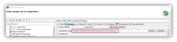

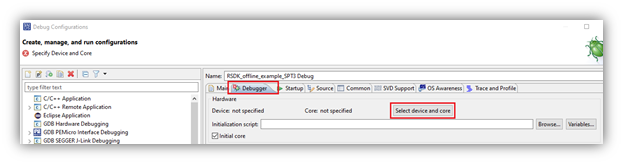

  5. There is an error showing that the Device core ID is not specified on the Debugger tab. Switch to the Debugger tab and click on the button ‘Select device and core’.

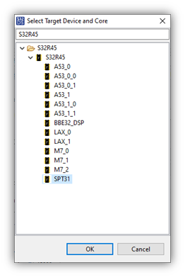

  6. From the Select Target Device and Core window, expand the listing until all cores are listed. Notice that all supported cores on the S32R45 are listed. Select the SPT31 core and click OK.
  7. Now that the device and core are selected, the attach script is selected automatically. The attach script will allow to start debugging on a core that is already initialized. This is correct for the SPT core as it is always launched in multicore scenario. Refer to the document 'README.txt' located in the same folder as these script files for details on all of the provided scripts.

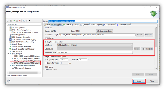

  8. Confirm the setting of the ‘Initial core’ checkbox. This box should be checked within the debug configuration that establishes the first connection to the target device via S32 Debug Probe. When this box is checked, the Debug Probe Connection interface and GDB Server settings become available. The probe connection only needs to be configured once and only one GDB Server needs to be running for each debug session. Therefore, this box should be checked for multicore debugging where A53 core is debugged via Remote Linux. If, however, the A53 and SPT cores are debugged via the S32 Debug Probe, then this box should be checked for the A53 debug configuration and should not be checked for the SPT debug configuration.

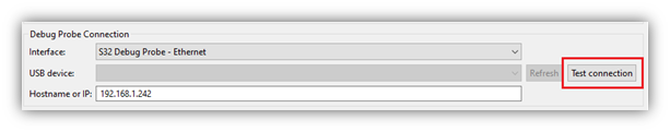

  9. If the ‘Initial core’ box was checked in the previous step, setup the Debug Probe Connection. Select either USB or Ethernet, depending upon your hardware setup. If USB is selected, the COM port for the S32 Debug Probe will automatically be detected (unless not connected or more than one probe is connected). If Ethernet is selected, then enter either the hostname (fsl + last 6 digits of MAC address) or IP address. It is highly recommended to press the ‘Test connection’ button to confirm the hardware connection is correctly configured. See the included ‘S32_Debug_Probe_User_Guide.pdf’ for more details on the setup of the S32 Debug Probe.
  10. Check that the GDB Client section has the correct path to the SPT GDB executable. It should point to the variable ‘S32DS_R45_GDB_SPT_PATH’.

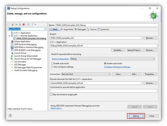

  2. Start A53 debug. From the menu at the top, select Run -> Debug Configurations…
  3. In the Debug Configurations menu, from the configuration list, expand the ‘C/C++ Remote Application’ group and select the ‘RSDK_S32DS_template_A53_Debug’ configuration.

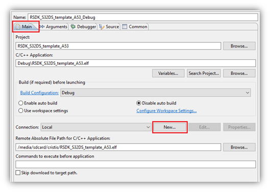

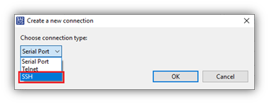

  4. On the Main tab, create a new connection for using the IP address of the EVB. The IP address could be determined either by issuing a Linux command over the serial connection, such as ‘ifconfig’, by accessing the local network connected device list, or perhaps the EVB was setup with a static IP address and it is already known.
    1. Click New… in the Connection section.
    2. Select ‘SSH’ for connection type.
    3. Enter the IP address in Host: field, use ‘root’ in User: field, and leave password field empty.

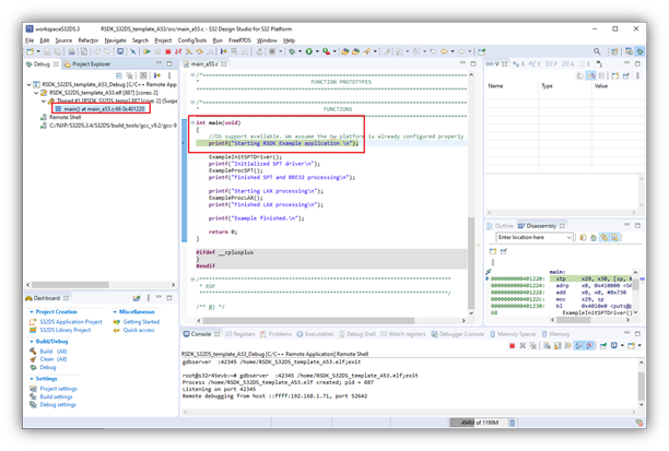

  5. Click Debug to start debugging on the A53 core.
  6. The debugger will launch and execute until the first executable line in main(). See Debugger tab in Debug Configurations menu to adjust this setting.

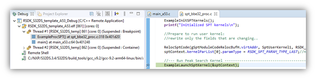

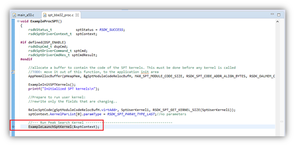

  7. Once the A53 debug session is running, advance the program counter to a line after the desired SPT kernel is loaded to memory but before the SPT kernel is launched. In the example here, this would be in ‘spt_bbe32_proc.c’, line 318, where ‘ExampleLaunchSptKernel()’ function is called. This is best done by setting a breakpoint on the line and clicking Resume.
  8. After the breakpoint is reached, the SPT debug session can be started.

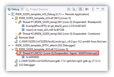

  9. Return to the Debug Configurations menu, select the SPT debug configuration ‘RSDK_S32DS_template_SPT31_attach’, confirm the Debug Probe Connection settings and click Debug.

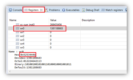

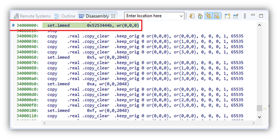

  10. Wait for the SPT debug session to launch and stop in the disassembly. Select the SPT debug thread to change the context of the Disassembly, Registers and etc.views. Now you can step through the assembly code, access registers, etc.
