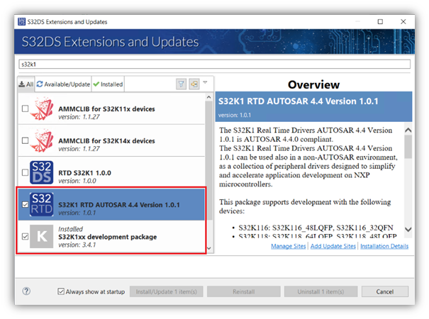

- Setup the software tools
- Install S32 Design Studio for S32 Platform
- Install the S32K1xx development package and the S32K1 RTD AUTOSAR 4.4. Both of these are required for the S32 Configuration Tools.

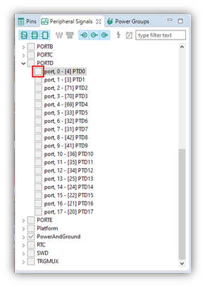

- By default, the Pins tool is then presented. For the Blinking LED example, one pin must be configured as output. The S32K144 EVB has an RGB LED for which each color is connect to a separate pin on the S32K144 device. For the blue LED the desired pin is PTD0. From the Peripheral Signals tab in the view to the upper left in the standard Pins tool perspective layout, locate PORTD, then PTD0 and check the box next to it.
- The Direction required! menu will appear. Select Output then OK.

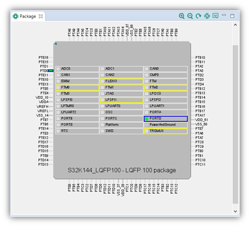

- Notice the changes which appear in the following views:
- Peripherals Signals
- Package

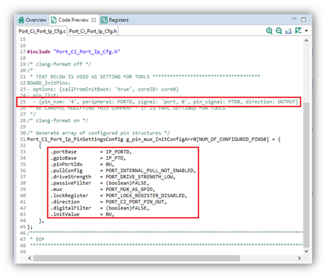

- Code Preview

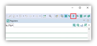

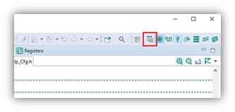

- Click on the Peripherals Tool icon from the Eclipse Perspective navigation bar.

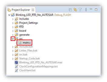

- If not already open, in the project window click the ‘>’ next to the ‘src’ folder to show the contents, then double click ‘main.c’ file to open it. This is where the application code will be added.

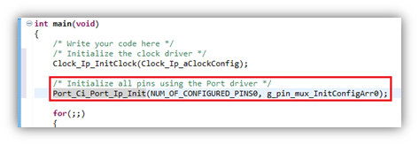

- Before the pin can be controlled, it needs to be initialized using the configuration information that was generated from the S32 Configuration tools. Initialize all pins using the Port driver by adding the following line:
Port_Ci_Port_Ip_Init(NUM_OF_CONFIGURED_PINS0, g_pin_mux_InitConfigArr0);

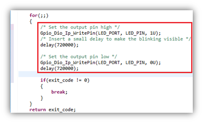

- Turn the pin on and off with some delays in-between to cause the LED to blink. Make the delays long enough to be perceptible. Within the provided for loop, add the following lines:
Gpio_Dio_Ip_WritePin(LED_PORT, LED_PIN, 1U);
delay(720000);
Gpio_Dio_Ip_WritePin(LED_PORT, LED_PIN, 0U);
delay(720000);

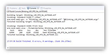

- Build 'Blinking_LED_RTD_No_AUTOSAR'. Select the project name in 'C/C++ Projects' view and then press 'Build'.
- After the build completes, check that there are no errors.

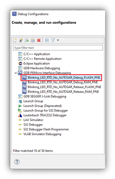

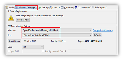

- Open Debug Configurations and select 'Blinking_LED_RTD_No_AUTOSAR_Debug_FLASH'. Make sure to select the configuration which matches the build type performed, otherwise it may report an error if the build output doesn’t exist.
- Confirm the EVB is connected to the PC via USB cable, then check the Debugger tab settings and ensure that 'OpenSDA Embedded Debug - USB Port' is selected for interface.
