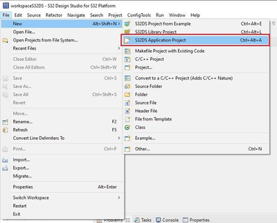

  1. New S32DS Project

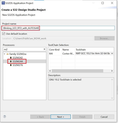

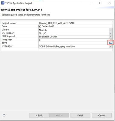

  1. Provide a name for the project, for example 'Blinking_LED_RTD_With_AUTOSAR'. The name must be entered with no space characters.
  1. Expand Family S32M2xx, Select S32M244
  1. Click Next
  1. Click '…' button next to SDKs
  1. Check box next to PlatformSDK_S32K1_S32M24_2_0_0_S32M244_M4F (or whichever latest SDK for the S32M2xxx is installed). Click OK

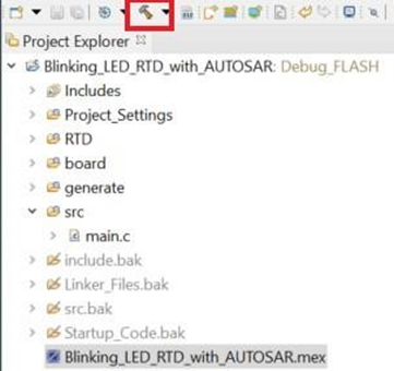

  1. Click Finish. Wait for project generation wizard to complete, then expand the project within the Project Explorer view to show the contents.

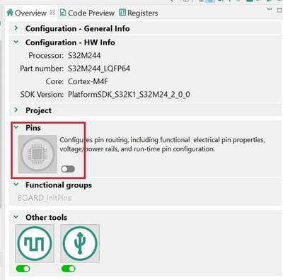

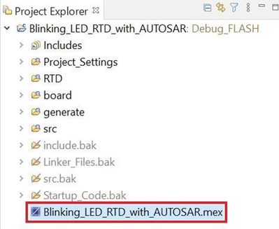

  1. To control the LED on the board, some configuration needs to be performed within the Pins Tool. There are several ways to do this. One simple way by double-click on the MEX file.
  1. Select the overview tab and disable Pins tool. Make sure to overview tab windows shows settings shown as below.  Here, we are disabling pin tools and using MCAL driver from peripheral tools for using AUTOSAR drivers.

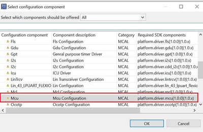

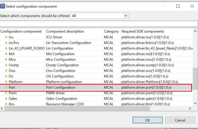

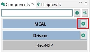

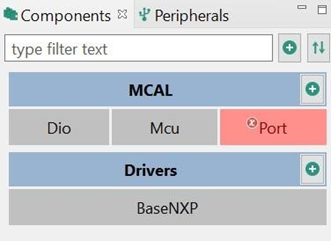

  1. Click on the ‘+’ next to the MCAL box.
    • Locate and then select the ‘MCU’ component from the list and click OK.
  • Click on the ‘+’ next to the MCAL box again, and Locate and then select the ‘Dio’ component from the list and click OK.
  • Click on the ‘+’ next to the MCAL box again, and Locate and then select the ‘Port’ component from the list and click OK.
Now components tab should show like below :
Ignore the error for Port component for now.

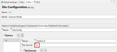

  1. Now we required to configure the different MCAL drivers that we added. Starting with Dio configuration, open the Dio configuration.
  • Now, open the ”DioConfig” tab. From that change Dio Port Id to 4 instead of 0
  • In that, select  “+” sign adjacent to Dio Channel.
  • Then edit Name to “DioChannel_0”and “Dio Channel Id”  to ‘6’ instead of ‘0’.
From the schematic for S32M244 EVB, we can select signal line for user LED from the schematic, channel 6 is connected to user LED signal, so we use channel 6 signal line to the chip on the user LED.

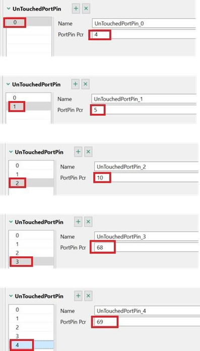

  • At the bottom you will find the “UnTouchedPortPin ’’ . Click on “+’’ and add PortPins.
  • Now add 6 port pins as per below configuration. Pins 0, 1,2,3, 4,5, and 6 should be setup.

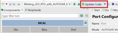

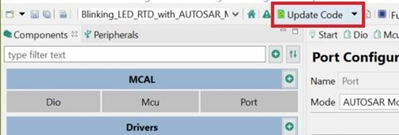

  1. Now the device configurations are complete and the RTD configuration code can be generated. Click ‘Update Code’ from the menu bar.

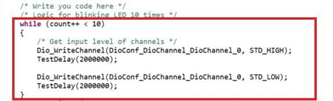

  1. Now replace the logic of for loop as shown below code section, which will enable the LED blinking for 10 times:
You also need to declare and initialize the loop variable uint8 count = 0U       Then replace the code as below:
                    /* Logic for blinking LED 10 times */        while (count++ < 10)
        /* Get input level of channels */
        Dio_WriteChannel(DioConf_DioChannel_DioChannel_0, STD_HIGH);
        TestDelay(2000000);
        Dio_WriteChannel(DioConf_DioChannel_DioChannel_0, STD_LOW);
        TestDelay(2000000);

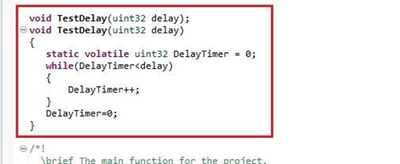

  1. Before the 'main' function, add a delay function as follows:
void TestDelay(uint32 delay); void
    static volatile uint32 DelayTimer = 0;
while(DelayTimer<delay)
        DelayTimer++;      }
    DelayTimer=0;

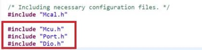

  1. Update the includes lines at the top of the main.c file to include the headers for the drivers used in the application:
Add
#include "Mcu.h"
#include "Port.h"
#include "Dio.h"

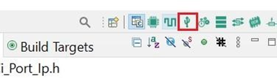

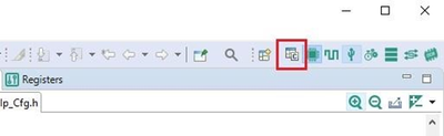

  1. Now, select and open max file again. Then, select and open peripheral tools.
 Now, from the toolbar selection menu at the top, select and double click on the symbol as shown as below:
Now, from the global settings, for ComponentGenerationMethod from that select
“FunctionalGroups” from the drop down menu as shown below:
Now. click ‘Update Code’ from the menu bar.
  1. Build 'Blinking_LED_RTD_AUTOSAR'. Select the project name in 'C/C++ Projects' view and then press 'Build'.
  1. After the build completes, check that there are no errors.
