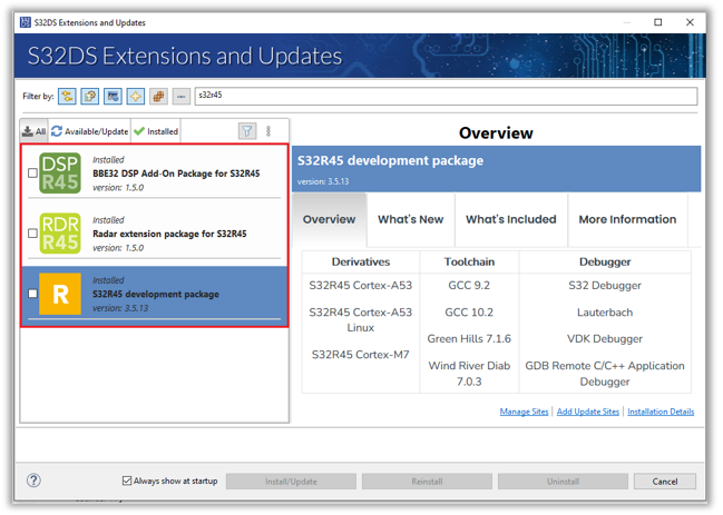

  1. Setup the software tools
    1. Install S32 Design Studio for S32 Platform
    2. Install the S32R4xx development package, the Radar extension package for s32R4xx, and the BBE32 DSP Add-On Package for S32R45.
    3. Install the ‘S32R45_RSDK_0.9.4_D2112’ last. It contains the ‘RSDK_S32DS_template’ example project. This package must be downloaded from the NXP website. If the .exe version is used, then the RSDK installer will install an XML file containing the install path of the RSDK into the S32 Design Studio installation directory. A prompt during the installation process will request the user to locate the S32DS installation directory. If the S32DS installation folder doesn’t exist, then it can’t be selected and the file will be missed. So, it is important to install this after installing S32 Design Studio and to use the .exe version. Once installed, S32 Design Studio will be able to locate the project from the New Project from Example wizard.

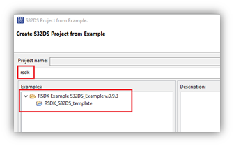

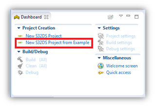

  1. Create the Project. Launch S32 Design Studio for S32 Platform and execute the following command:
    1. File -> New -> New S32DS Project from Example
      OR from the Dashboard
    2. Enter search text ‘rsdk’. The RSDK_S32DS_template project will be shown. Select it and click Finish.
