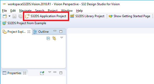

1. Launch S32DS for Vision
2. Select 'S32DS Application Project'
3. Enter a name for the project

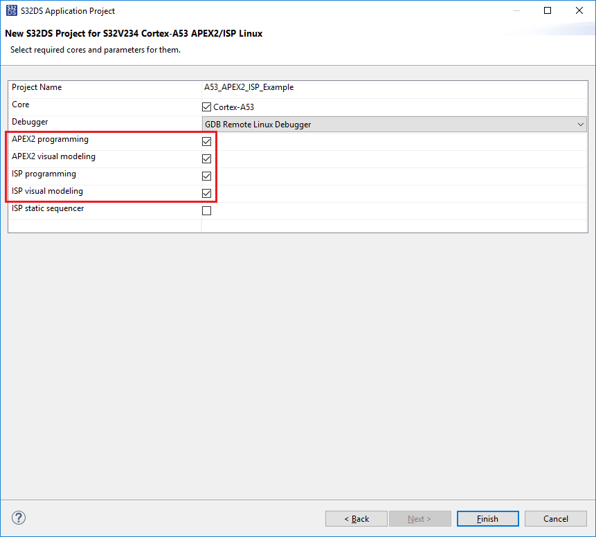

4. Select the 'A53 APEX2/ISP Linux' processor option
5. Click Next
6. Select the APEX2/ISP options you need.
      a. APEX2 programming - will add support to your project for an APEX2 application, you need this for any new APEX2 project
      b. APEX2 visual modeling - will create a separate project for your APEX2 program diagram, you need this to connect your APEX2 graph diagrams together. But you could also create it separately later. The APEX graph diagram must be created separately with another New Project Wizard.
      c. ISP programming - will add support to your project for an ISP application, you need this for any new ISP project
      d. ISP visual modeling - will create a separate project for your ISP data flow diagram, you will not need this if you plan to use an existing graph diagram. This can also be created later.
      e. ISP static sequencer - by default, a dynamic sequencer is generated from your graph diagram, enable this to generate a static sequencer instead. This can be set/changed later in the Emit Configurations.
7. Click Finish
8. You now have a project or set of projects for development on the S32V234.
