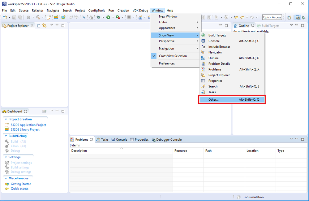

1) Go to 'Window -> Show View -> Other'

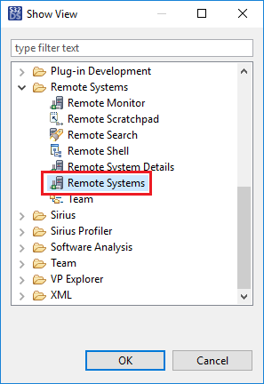

2) Expand 'Remote Systems', then select "Remote Systems' and click OK

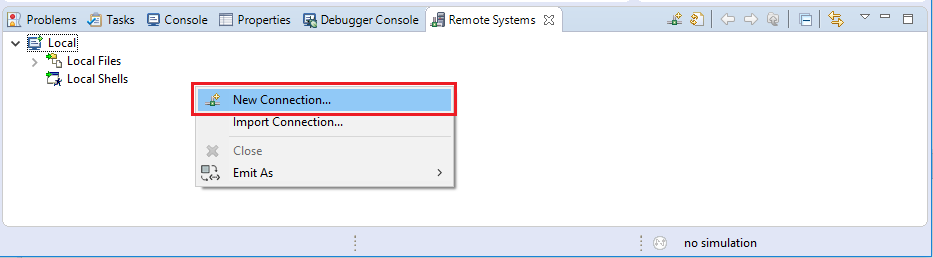

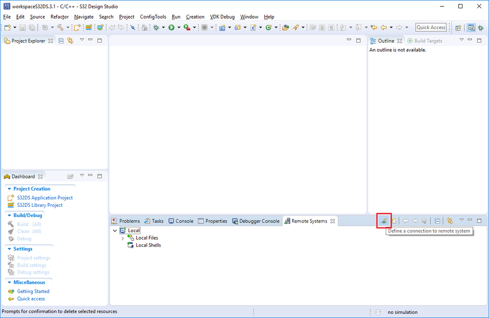

3) Click 'Define a connection to remote system' button OR right-click in the Remote Systems window and select 'New Connection...' from the list

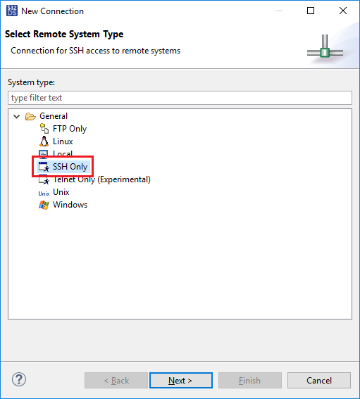

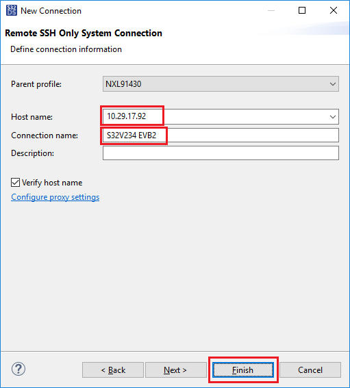

4) Select 'SSH Only'
5) Enter the IP address noted from HOWTO: Setup A Remote Linux Connection in S32DS (S32V234) for Host name, enter a descriptive name for the connection (optional) and click Finish.

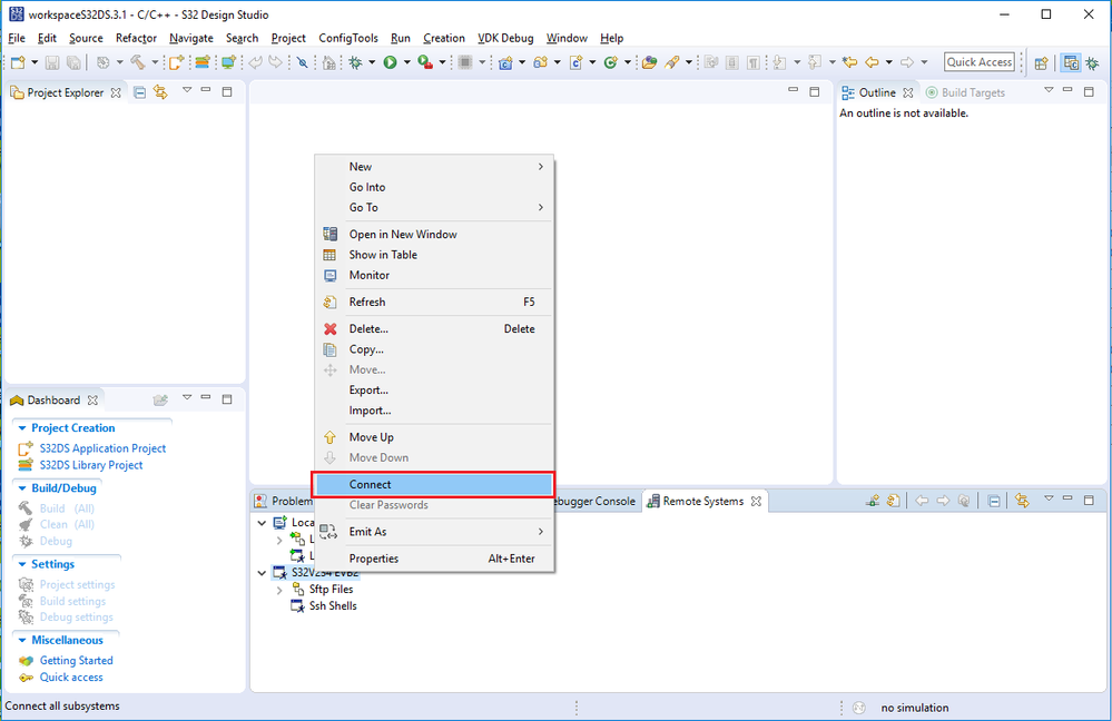

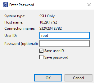

6) Right-click on the connection name in the Remote Systems window and select 'Connect' OR expand the folders under the connection name until the login window appears: Connection_name -> Sftp Files -> Root (window appears)
7) Enter "root" for User ID and since the BSP comes with ID root without a set password, leave the password field blank.
8) Click OK

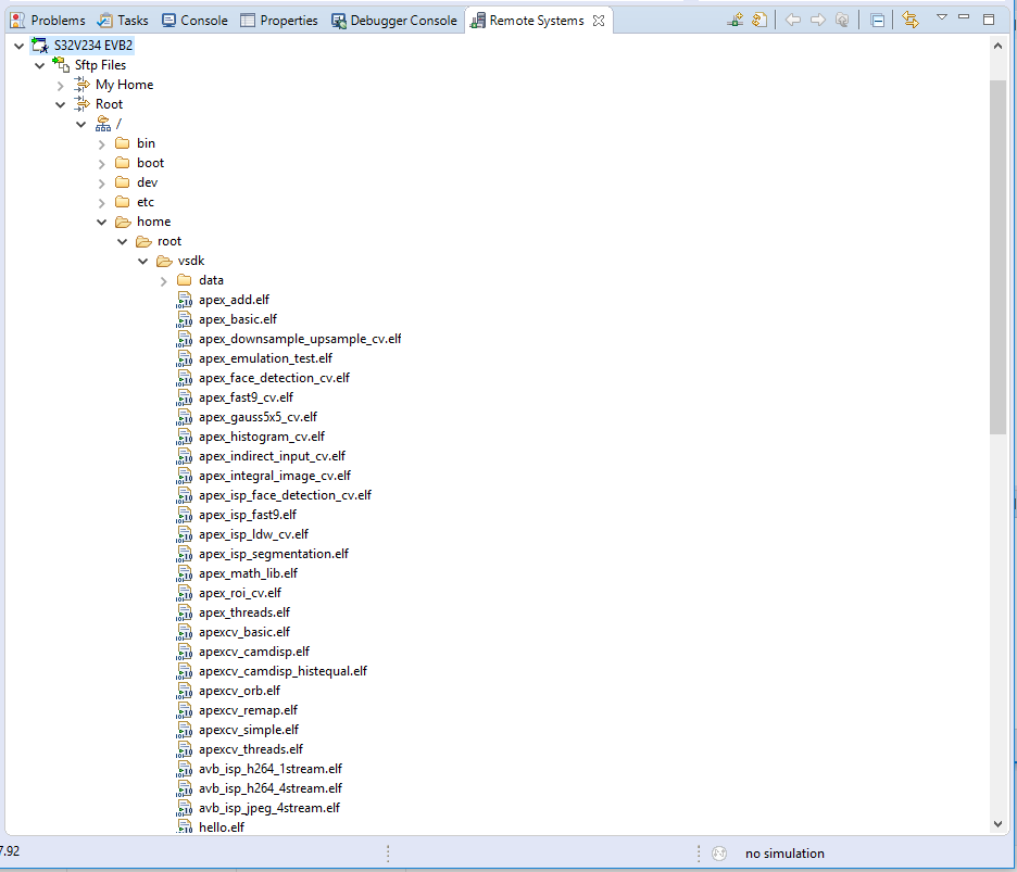

9) The Linux file system is now visible in the Remote Systems window. You can drag and drop files to and from here. Expand the folders to see the contents.
