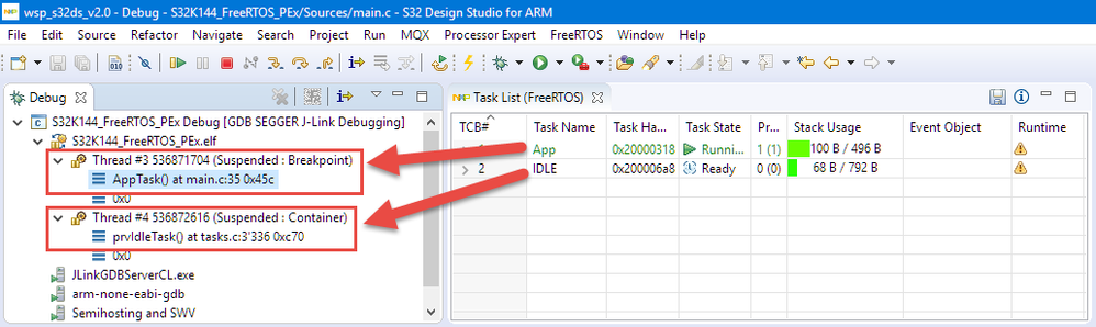

The following article describes how to add FreeRTOS thread aware debugging to the Eclipse Debug view using SEGGER J-Link:
Show FreeRTOS Threads in Eclipse Debug View with SEGGER J-Link and NXP S32 Design Studio | MCU on Ec...
I hope this is useful,
Erich
