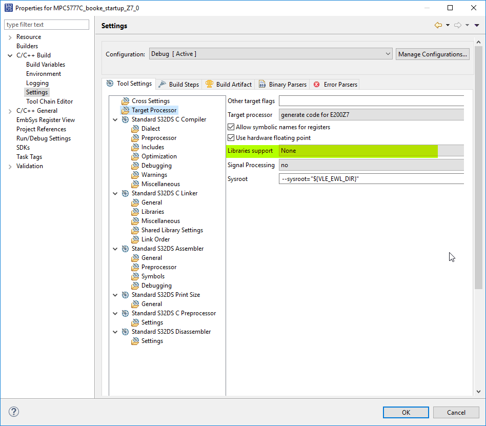

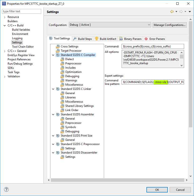

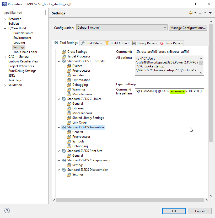

Example contains modified startup code to be able run in BookE only mode. For GNU gcc and as you need to add -mno-vle parameter in project properties:
For debugging with PE Micro you need to use modified Initialization script in Advanced options:
Please note that there is no STD C BookE only library available:
