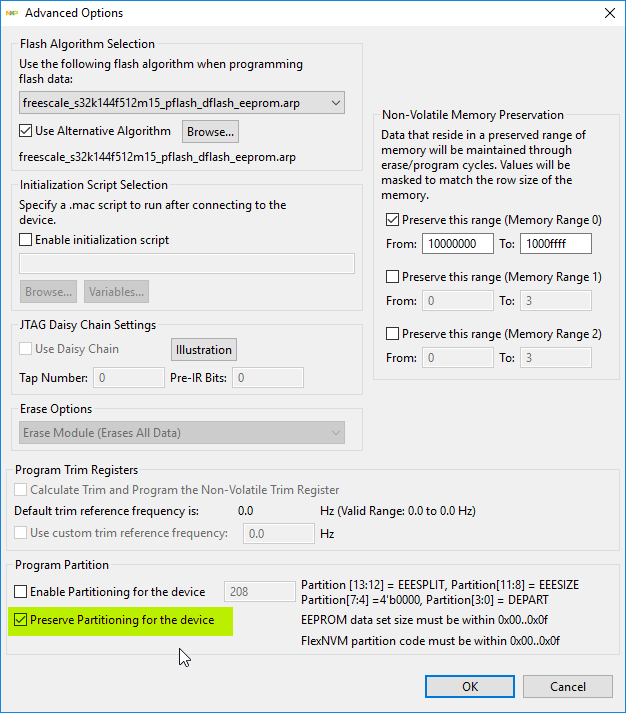

Please, can you guide me how should I make sure,  Data which I have written to FLEXRAM, those data have been copied to  D-Flash bu background process?
Because after Write to FlexRAM once reset those data not available in RAM Location,
Ex:
EEE_Write_int32(123456,&eeerom_data.i1);
Reset
EEE_Read_init32(&eeprom_data);
Data this location FFFFFFFF
Plase can you guide me how can verify the written data?

Sorry for confusion - I don't have much time for testing - I put logical instead binary & operator in EEE_Init(). The EEE_Init() was not working. In attachment is updated example.
with the Example EEE_Init() function - data are loaded automatically into EEERAM mapped structure. By reset you mean pressing Reset button on EVB or Re-Flashing by PE Micro? With re-flashing without memory preservation is DFLASH area erased.

Please check, Below sequence and configuration
1) PE Configuration
2) UART Output
3) Firmware.
Main()
Init_EEPROM()
Problem:
When Write-Read Sequence OK
When only Read Sequence -NOK
Please, can your tell me anything I'm Missed out?
As I mentioned - there is bug in the Init_EEPROM (current example version is fixed). Please use binary & instead logical one:
if ((FTFC->FCNFG & FTFC_FCNFG_EEERDY_MASK) == 0U)
Emergency kinetis device recovery overrides Memory preservation - So don't use it. Also don't use Partitioning - it will be done by Init_EEPROM.

Please check if the FTFC->FCNFG->EEERDY bit is set to 1 before you run EEE_Write. It looks like that in your config is EEERAM area used as standard RAM.

Now I can able to get back the Written data in FlexRAM, But I have another problem is that Re-Flashing  will erase the Written Data,
what should I do for overcoming this issue?
Should I modify the linker file?  which part of the linker file has to change?
Sakthivel K
If you have preserved DFLASH memory (full DFLASH is from 0x10000000-0x1000FFFF) - PE Micro doesn't rewrite your stored data.
Also be sure that there is unchecked Emergency kinetis device recovery and you didn't perform partitioning via PE Micro.

Yes below my setting,
The sequence is that,
►Write FlexRAM (14000000)
►Reset
►verify the structure variable mapped to EEPROM.(14000000) -OK
►Modfity the Application Build and Flash by OPENSDA on EVB Board.
►Reset
►Verify the structure variable mapped to EEPROM(14000000) data will be erased. -NOK
I have preserved the D-Flash Range, why data has been overwritten?
My Requirement is that
if the user configured the data only once should not be erased by updating the Program(Re-flash).This just program update not the configuration data update.
well - that's exactly for what memory preservation is used - and is working okay. There must be different issue with your project. The fundamental is - EEERAM partitioned as emulated EEPROM (FTFC->FCNFG->EEERDY = 1 ), and memory preservation. The example at very top is working for you? If it is possible - can you please share your project with me? I'll look at it.

finally - I can reproduce the issue - thank you for keep going this thread. I didn't realize that in my case there was not change in the code. So - when there is code change, the DFLASH is preserved, but the emulated EEPROM partition is removed -> stored data are gone. I tried use partition with PE Micro, but for some reason pegdbserver always crashes. I'll try to findout some workaround.
Jiri
The preserve partitioning should do the trick - but it failed because of PE Micro bug:
I'm going to create bug ticket for PE Micro.

Is this "preserve partitioning PE Micro" bug solved yet?
Or is there any other working solution?
Just installed S32DS 2.2, and fully updated (also all PE Micro up to date) but no luck! (Same on S32DS-18)
Same problem on 2 computers Win7 64bit...
Tested with both OpenSDA and Multilink Universal.
I'm using the other SDK EEPROM example. (Referred in top post)
Everything seems to work, except when you use "preserve memory range", the pegdbserver always crashes, and can not load/flash the target successfully.
With OpenSDA:

unfortunately PE Micro won't fix it. Here you can find more details:
https://community.nxp.com/message/1269942
Jiri
