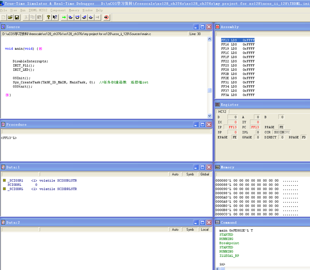

when I used PIT0 and SWI interrupts the program can't run,【ILLEGAL_BP】

Recently I am transplanting ucosii on xs128.When I use PIT0 or SWI respectively, each of them could enter thier blackette,but use them at the same time the program running out of truck. By the way, there is no question if I used TIM7 and swi at the same time. How can I use PIT and swi at the same time ?

That is strange. Please share here your code for PIT0 initialization, PIT0 and SWI interrupt routines.
Did you enable COP watchdog? – is it possible that execution of PIT0 and SWI ISRs increased interval between watchdog triggering?
Illegal_BP means that debugger got lost.

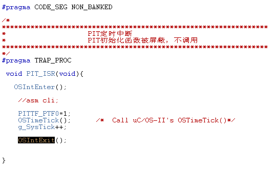

I could not see anything wrong in your INIT_PIT() function.
But your code in PIT_ISR is strange.
You used “asm cli” command for enable other interrupts prior you cleared PITTF_PTF0 flag. Since there is 1-cycle (bus clock) delay in the clearing mechanism for the I bit, PITTF_PTF0 flag will be cleared anyway. However exact time of OSTimeTick() function execution depends on number of pending interrupts… This does not make sense for me. OS tick time based on Periodic interrupt should be accurate and without any necessary jitter. Why did you clear I bit in middle of PIT ISR?

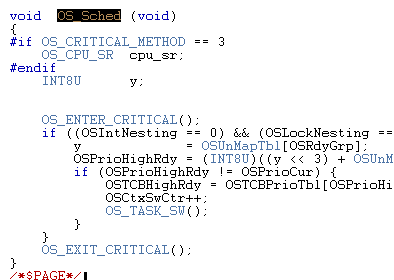

The strange is also your code in OSCtxSw.
I suppose that you used SWI for some “context switching”, but your implementation is quite insufficient.
If I understood correctly - You saved PPAGE, modify stack pointer and restore back PPAGE. This could “work” only when all functions will be in non-paged flash. When you want execute some code from banked flash, you have to change stack pointer and PPAGE. Additionally, context switch should modify also basic CPU registers…
I would like to apologize, but I don’t have experiences with uCOSii OS.
For now I suppose that there will be probably some issue with inconsistency between modified stack pointer and PPAGE.

       yes,when I debug my code, It went wrong.
       After watching your receive, I try to chek my XS128 register.

        I  try to replace it to  OSCtxSw(), let PPAGE and stack pointer  be saved before switch context,the program run correctly.
   So I think there is some wrong when PIT interrupt  come,perhaps some registers couldn't be saved correct,When this code
   delay is over, program want to execute this part of code from break point, because of the registers' mistaken saved or someting wrong
   else when PIT interrupt's coming.
       However,I modify my code,let PPAGE and stack point be saved again before switch context , problems seems go away,although I still
   do not know why and how it happend.

RadekS
Hi 崇锐 卢,
The problem is probably that when you clear I bit (asm cli;), your PIT interrupt routine may be interrupted by any other interrupt. Since your OS implementation is full of assembler code (not handled by compiler), it is possible that OS function simply do not suppose such case (nested interrupts – ISR interrupted by ISR).
In general - some critical system functions needs to be executed in once, interruption in middle of these functions may cause dangerous situations. For these parts of code, interrupts must be disabled.
Please check whether functions like OSTimeTick(); or OSIntExit(); may be interrupted.

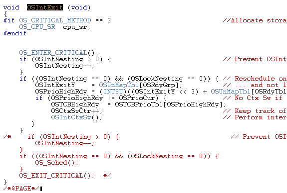

xianyu
but I am afraid it isn't the reason, after I do this, still Illegal_bp
anyway,I think there is something wrong with PPAGE and stack point , beacause if code like follow
this program run correctly
pastedImage_5.pngand the difference between OSIntCtxSw and OSCtxSw is that OSCtxSw saves regesiters and OSCtxSw not,although I still didnt not which register is wrong.
At last , [asm cli]  which is used in that place is truely inappropriate,ISR interrupt truely could be interrupted by another interrupt,thanks for your prompt.
