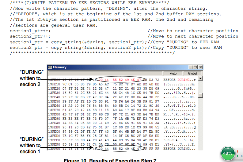

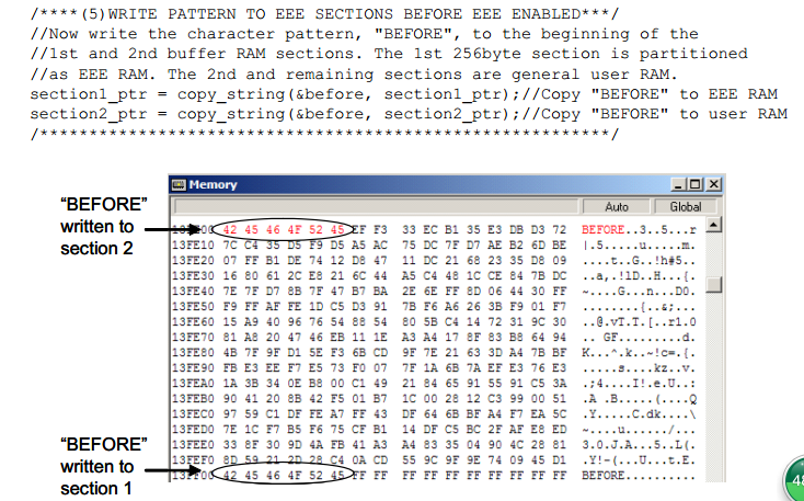

when i see the An3743,there are some question . when us use the EEE,if the  EEE is enabled  is necessary?Because in the An3743.step 5 is write data(before) before EEE ENABLED.pastedImage_1.png
step 7 is write data(during) after  EEE ENABLED.

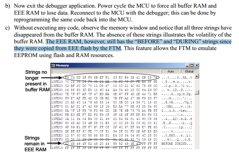

at last,power cycle the mcu,then  Without executing any code, observe the memory window and notice that all three strings have disappeared from the buffer RAM. in the EEE RAM, however, still has the “BEFORE” and “DURING” strings since they were copied from EEE flash by the FTM .
So what is The difference between the  EEE ENABLED and not  EEE ENABLED. Is it is necessary to EEE ENABLED when i use the EEPROM?

RadekS
Hi 展辉 刘,
The observed behavior is fully expected.
The AN3743 example configure Buffer RAM from 0x13FF00 as EEE RAM, while range 0x13F000-0x13FEFF woks as standard RAM.
The EEE consist from (part of) D-Flash and (part of) Buffer RAM (called EEE RAM in AN3743). The D-Flash must be partitioned prior first use as EEE.
The loading EEE RAM from D-Flash after reset is performed automatically.
The EEE Enable command is necessary for starting store EEE RAM changes into D-Flash.
So, if you will not execute EEE Enable command, the changes in EEE RAM will be not stored into D-Flash and the EEE RAM will be loaded by last known values after next power cycle.
So, you should execute EEE Enable command when you want to store your EEE RAM changes into D-Flash.
