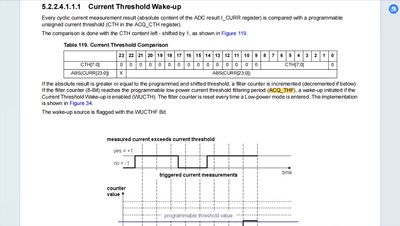

hello!
I read the following information and I have a question.The maximum CTH value is only 500mA

yes, correct!
