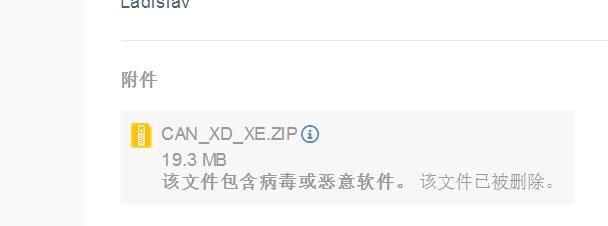

thanks for your reply,but the attached example was deleted for the virus.can you send it to 981807702@qq.comor upload it again?thank you so much! I will follow your suggestion!

I have changed the file extension to bmp. The issue was that the CodeWarrior files contain *.cmd files which are recognized by community antivirus. Unfortunately incorrectly in this case.
Ladislav
