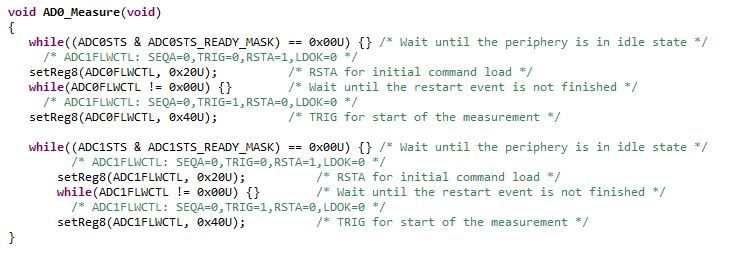

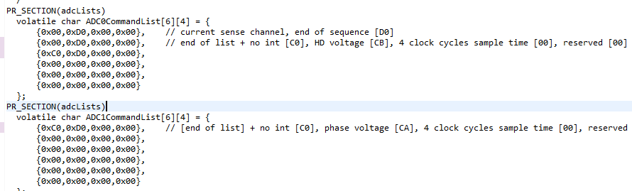

I use the S12ZVMC128 chip, and i want to PTU to trigger  ADC , then get DC current.
But when i set  ADC CommandList  as shown  below ,   (0xD0 is the channel of DC current) , the results in ADCResultList  are different.(DC current is constant.)177644_177644.pngpastedImage_1.png
what's more, if i don't use the module as shown below ,the results of DC current   I get    are   zero.
The code file is in the attachment.
could you help me and check the code file,find the bug .
by the way ,could you tell me how can i use PTU to trigger  ADC , which registers should i pay more attention?

I haven’t found any bug in the code. Do you use the software for development kit or you modify own project? Could you attach the project? How significant is the change in results and how did you get stable current?
If the change is significant, there might be a problem with memory allocation. Are the lists properly aligned? Have you tried putting it directly at aligned address?

3,   memory allocation is configured in the mc9s12zvmc128.prm  file.
