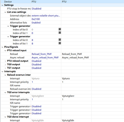

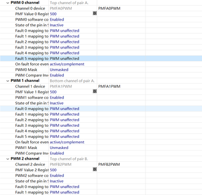

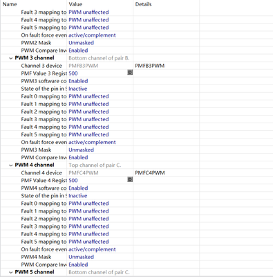

  I use the S12ZVMC256 chip, and I want to through PMF to trigger  PTU.I have configured the program which generated by PE.And I can trigger TG0 through PMF reload event,but I can't trigger TG1.I observed that PTU reload override interrupt flag (PTUIFH_PTUROIF) has been set to 1.There may be a problem in the configuration process.I see that multiple trigger values can be set,And how do I verify that multiple triggers have been implemented.Here are the settings in my PE.

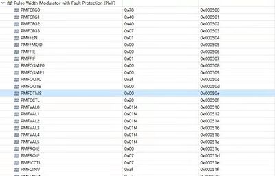

 The following are the register parameters of the module after initialization

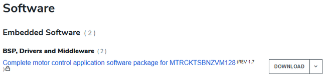

I would recommend starting with an existing demo project for motor control.
https://www.nxp.com/design/development-boards/automotive-motor-control-solutions/magniv-and-s12-solu...
Or you can refer to the attached S12ZVM hands-on labs.
The processor expert is good for the initialization only.

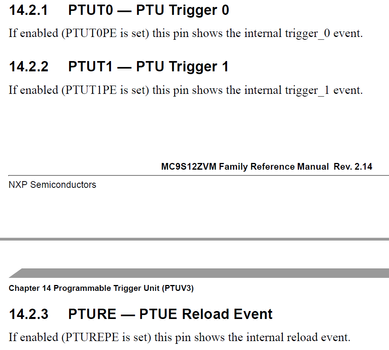

You can scope the triggers and the reload signal on external pins.
