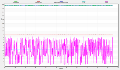

hello,
could you please help to check why Iq current has so big oscillation?
7 回复数
10,343 次查看
HuabiaoTang
What's your motor parameters and your MCAT configuration?
Is it a small Inductance motor?  if yes, you may need increase the foc frequency. for example, from 20kHz to 25kHz.
if not, general speaking, you can decrease the current loop frequency, for example, 150Hz. if it still not optimized,
the another cause may related with your current sampling hardware.
you can verify the current sampling quality by monitor the phase current  ABC when motor is stopped.
hope helps,
regards,
Raymond
10,334 次查看
peter_shi
I used S12ZVML128, the single shut resistance sampling. I could run motor in open loop.
I checked the Iq has big oscillation, it couldn’t switch to close loop.
Resistance and induction are very small.
Rs = 0.05ohm
Ld = 40uH
Lq = 60uH
BEMF = 3V@1000RPM
10,329 次查看
HuabiaoTang
the inductance is small, but L/R is still in normal range.
What's your current loop F0 and your FOC frequency?
would you paste the angle scope of FreeMASTER in tracking mode?
or would you upload your motor parameter file?
you can do current loop diagnose, set a step current command, for example 2A, and then monitor the current response to check whether the loop F0 is suitable or not. If the real current response is lag the command obviously, you can increase the F0, if it response will overshot the command, you can decrease the F0.

peter_shi
Please refer attachment, and no estimated angle in tracking mode.

peter_shi
I used the external bus votlage divide circuit.
for the following parameter:
#define MERG_SPEED_1_TRH 500RPM
#define MERG_SPEED_2_TRH 800RPM
Attach is 800RPM's test data and current.
