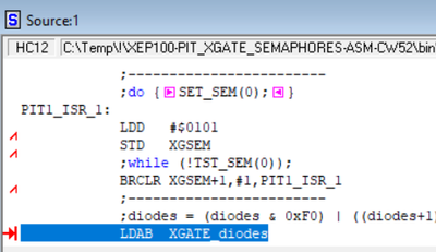

OK, another example I created now (based on c project, disassembled and ported to the asm project), just to know whether I have not forgotten.
…not RTI but two PITs generate periods. One at CPU (PIT1) and another one at XGATE (PIT0). Both modules use a shared 8bit variable XGATE_diodes which is modified in PIT interrupts and access to this variable is controlled by semaphores.
It shows you, I think everything. I have also used different addressing styles .. once with register definition and once with direct number…just an example.
..as I expressed myself many times....in this case I would not us asm programming at xgate. much simpler is C coding which also automatically solves many issues you can hit.
Boht projects ASM and C are attached.

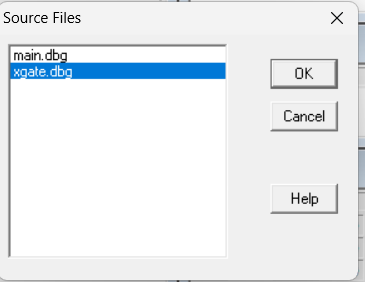

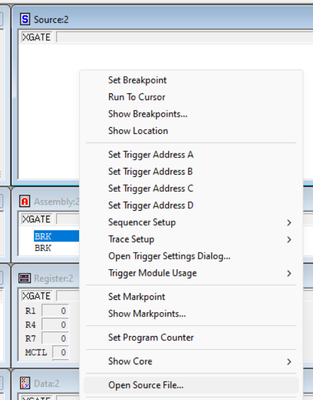

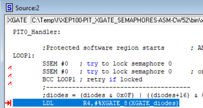

b) press right mouse button while pointer is on empty window, open source file, select xgate.dbg and break point into the PIT0_Handler.
You can see after run it stops in xgate
as well as in cpu

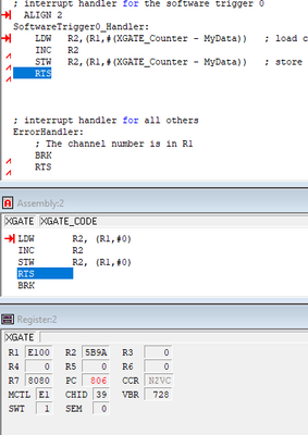

I'm not getting very far with this. I created the new sample project with relocatable assembler and XGATE as you suggested. When I run it and stop it again, I can see that the counter has been updated as well as the Fibo result. When stopped I can see that XGATE R1, R2, R7, PC, MCTL, CHIP and VBR have changed, or at least some have.
When I step through the main.asm code I can follow it along and see the numbers and registers update, but at no point do I see where it runs the XGATE code.
It looks like all the XGATE code does is update the counter when the software interrupt is triggered, but I don't see what initiates that software interrupt for XGATE.
14,667件の閲覧回数
lama

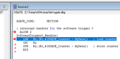

The SWI is only enabled in the example so I suggest you to set breakpoint
And select XGATE window (see in the picture it is darker blue) then press run. Each time the interrupt is finished and when it goes to the interrupt machine it is evaluated as a pending interrupt so it is launched again.
…. And able to see all changes
… after few steps ….

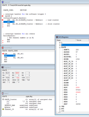

I had taken a couple of days to study the code in depth, step through it, and note the states of the relevant registers and variables at each step. I determined that the variable  XGATE_Counter is located at address $2100:2101, variable Counter is at address $2102:2103 and variable FiboRes it at address $2104:2105.
I followed your instructions to step through the XGATE code and watched the RAM memory. Then it dawned on me that I didn't fully understand how this code is supposed to work. I assumed that XGATE was used to update Counter, but that doesn't appear to be the case. All it does is increment XGATE_Counter, which has nothing to do with calculating the Fibonacci number.
Assuming this is correct, it has been quite a learning experience, but I'm still stumped on how I can use XGATE.
I would like to start by using it in a short routine using RTI to establish some time rates and set some flags so the program can use them in the main loop for different routines. Is there some example code available that might help me get closer to this goal?
