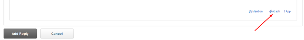

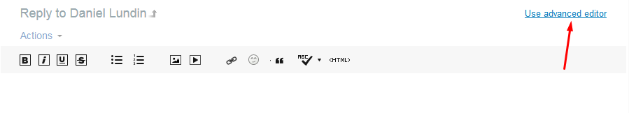

For attaching file you have to switch to advanced editor (I hate this aproach the same way as you.):
after that, you could attach file.
