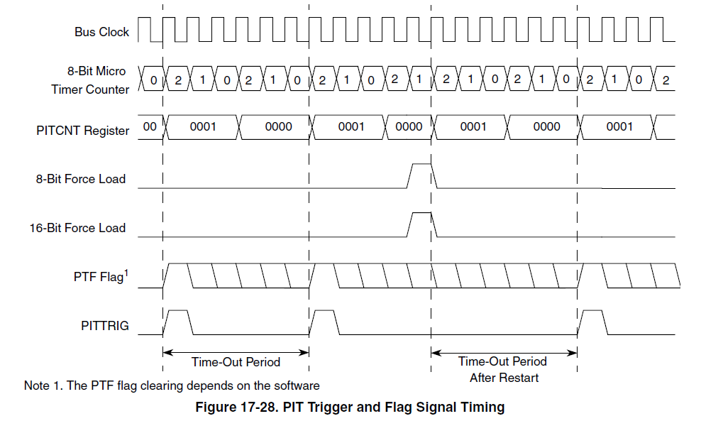

According to RM (chapter 17.4.1 Timer):
“Whenever a 16-bit timer counter and the connected 8-bit micro timer counter have counted to zero, the PITLD register is reloaded and the corresponding time-out flag PTF in the PIT time-out flag (PITTF) register is set, as shown in Figure 17-28.”
Therefore, PTFx flag is set when modulus down counter is reloaded from 0x0000 to PITLDx value.
Since value 0x0000 is also the valid value for modulus down counter, we have to set (time interval in us-1) as PITLDx value. Of course, that is valid only for cases where micro timer modulus down-counter produces 1us time base.
So, for your cases:
    Case1. PITLD0 = 1000 -> 1001us
    Case2. PTILD0 = 999  ->  1000us
I hope it helps you.
