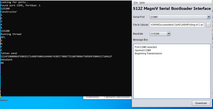

I am trying to program the s12zvl DHRD-S12ZVL-NCX3320 via the Serial bootloader interface but it doesn't work.

Hello @adrimen_9,
Please make sure you routed the SCI module to the correct RX/TX pins on the board.
You can start with a simple SCI example (attached) and use a logic analyzer to scope the bus, just to test the connection.
BR, Daniel

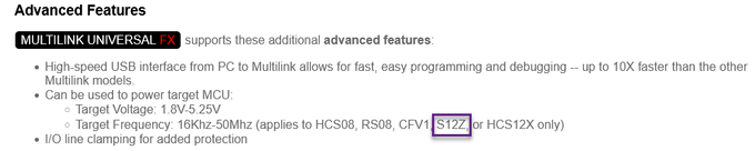

danielmartynek
Hi @adrimen_9,
You need to have CW11.1 IDE for MagniV
Evaluation version can be downloaded here:
https://www.nxp.com/design/software/development-software/codewarrior-development-tools/codewarrior-l...
And a programmer
like PE Micro Multilink FX
https://www.pemicro.com/products/product_viewDetails.cfm?product_id=15320180&productTab=1
