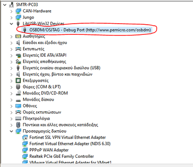

Device manager detects USBDM:

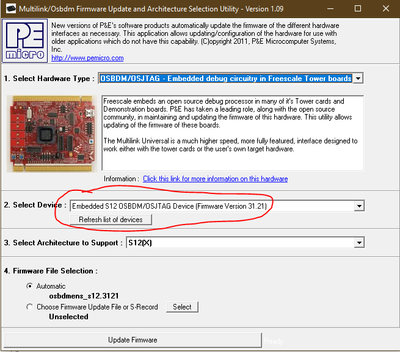

pemicro firmware updater detects USBDM (I have updated USBDM with the latest firmware):

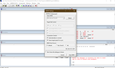

CW cannot detect USBDM

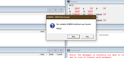

When I press the button "Open BDM" it gives the following message:

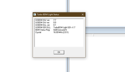

USBDM status gives the following:

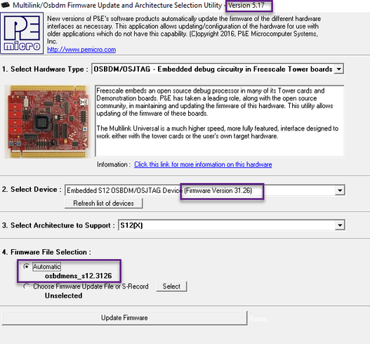

It looks like you use an old version of the Utility.
I tested with the below firmware on Win10, CW5.2, S12XE100 DevKit.
