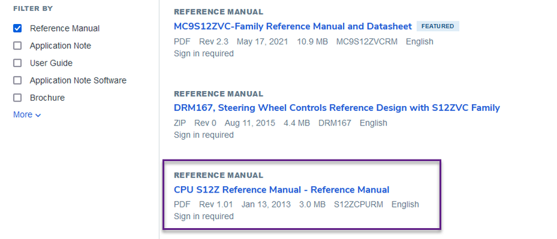

Hi @SCort_li,
Normally, this ISR can't be preempted by itself or by an interrupt with the same or lower priority.
If you need this ISR to be preempted by itself, you would need to overwrite the Condition Code Register (CCR) of the core, bits IPL[2:0] holds the current priority level.
For more information please refer to CPU S12Z Reference Manual
https://www.nxp.com/products/processors-and-microcontrollers/additional-mpu-mcus-architectures/s12-m...
