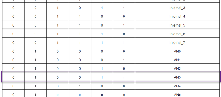

In the CommandList I do not know how to access the AN0_3 channel and there is no help in datasheet.
I also want to know what is the adc0readlist is doing and it's structure. What is the meaning of 32758 in adc0readlist.

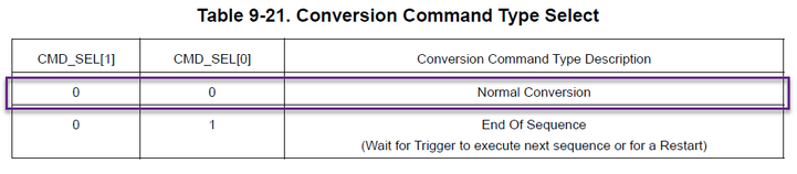

You have currently one ADC conversion in a single sequence.
Every sequence requires a trigger.
If there is anough time for two conversions in a sequence (between triggers), you can add one Normal Conversion to the list.
For example:
{0x40,0xD0,0x00,0x00}, // end of sequence [40], current sense channel [D0] - dc bus current on op-amp0
{0x00,0x30,0x00,0x00}, // normal conversion [00], AN3 [0x30]
