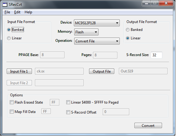

  i want use sreccvt in command -line by my script .    i can convert in GUI  , but i do not known how to set command -line option parameter.
my command -line as below, target:  convert bank address to linear address
sreccvt.exe  -b 8 0x08 32 -o out.s19 ck.sx
hope kindly man give me some good answer.
